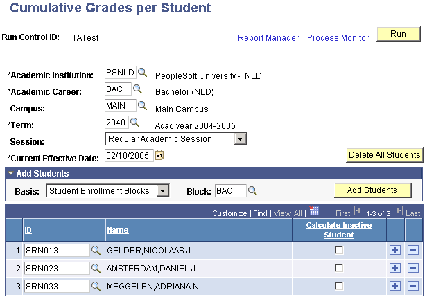

Access the Cumulative Grades per Student page (select Records and Enrollment, then select Test Administration NLD, then select Cumulative Grades per Student, then select Cumulative Grades per Student).
Image: Cumulative Grades per Student page
This example illustrates the fields and controls on the Cumulative Grades per Student page. You can find definitions for the fields and controls later on this page.
Field or Control
Definition
Basis
Select how the system selects students for the calculation process. The values are Enrollment in Classes, Student Enrollment Blocks, and Student Groups.
Block, Class, and Group
Enter the enrollment block, class, or student group for the system to calculate grades.
Calculate Inactive Student
Select to have the system consider grades for students who are no longer active in the academic career in the calculation process.
