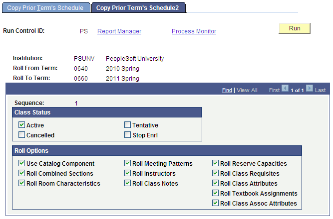

Access the Copy Prior Term's Schedule2 page (select (Curriculum Management, then select Roll Curriculum Data Forward, then select Copy Prior Term's Schedule, then select Copy Prior Term's Schedule2).
Image: Copy Prior Term's Schedule2 page
This example illustrates the fields and controls on the Copy Prior Term's Schedule2 page. You can find definitions for the fields and controls later on this page.
Class Status
Use the Class Status group box to indicate the status for classes that you want to copy. Values are Active, Cancelled, Tentative, and Stop Enrl. Each of these values corresponds to the class status value on the Enrollment Cntrl page.
Roll Options
Specify the type of information that you want to copy by selecting the appropriate roll options.

Use Catalog Component
Select this check box to validate against the course catalog and only roll those sections to the new term that are valid components of the course as defined in the course catalog. If you do not select this check box, the system copies all sections to the new term, regardless of the component designation.
Note: If a dynamic class date rule is associated with a class, you can still use the Prior Term Copy process by selecting the Use Catalog Component check box because the rule rolls from the course catalog. However, in order to calculate deadline dates, you must run the Dynamic Class Dates process within the copy to term.
Roll Combined Sections
Select this check box to roll combined sections that are designated as a permanent combination (on the Combined Sections page) to the new term.
Roll Textbook Assignments
Select this check box to roll textbook assignments. All data is carried forward except Textbook Assignment Status, which is set to Pending.
See Defining Textbooks for Classes.
The remaining options are self-evident.
Note: If your institution uses the Instructor Workload feature, you should follow the Prior Term Copy process with the Workload Copy/Update process using the same roll from and roll to terms. This final step ensures that the process creates term workload records for all copied Schedule of Classes data.
