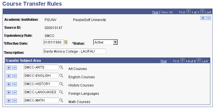

Course Transfer Rules
TRNSFR_RULE
select Records and Enrollment, then select Transfer Credit Rules, then select Course Transfer Rules, then select Course Transfer Rules
Define course transfer equivalency rules for external organizations or internal academic institutions.

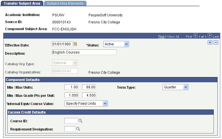

Access the Transfer Subject Area page (select Records and Enrollment, then select Transfer Credit Rules, then select Transfer Subject Area, then select Transfer Subject Area).
Image: Transfer Subject Area page
This example illustrates the fields and controls on the Transfer Subject Area page. You can find definitions for the fields and controls later on this page.
General Fields
Field or Control
Definition
Catalog Org Type (catalog organization type)
Designates the table from which you select a catalog organization for the component subject area of the specified source.
External: The system prompts you with external organizations in your system. Define external organizations on the Organization Table page.
Internal: The system prompts you with academic institutions in your system. Define academic institutions on the Academic Institution Table page.
Catalog Organization
Enter the catalog organization for this component subject area of the specified source. By default, the system displays the specified source as the catalog organization, but you can override this value. The system prompts you with values based on the value that you entered in the Catalog Org Type field. When defining course equivalencies for the component subject area of the specified source on the Subject Area Elements page, the system prompts you with incoming courses based on the catalog organization value that you enter here.
You can use any external organization or internal academic institution as the catalog organization to define course equivalencies for this component subject area of the specified source. However, after you define a course equivalency on the Subject Area Elements page, the Catalog Org Type and Catalog Organization fields become unavailable.
Component Defaults
Use the fields in the Component Defaults group box to define default information for incoming courses that you select for this component subject area of specified source on the Subject Area Elements page. Later, you can override these default values for an individual incoming course by clicking the Incoming Course Information link for the incoming course to change on the Subject Area Elements page.
Field or Control
Definition
Min/Max Units (minimum and maximum units)
Enter the default minimum and maximum units for all incoming courses that you define for this component subject area of the specified source.
Term Type
Enter the default term type for all incoming courses that you define for this component subject area of the specified source. By default, the system displays the term type defined on the School Data page in the Organization School Data component. Values for this field are delivered with your system as translate values. You can modify these values.
Min/Max Grade Pts Per Unit (minimum and maximum grade points per unit)
Enter the default minimum and maximum grade points per unit for all incoming courses that you define for this component subject area of the specified source.
Internal Equiv Course Value (internal equivalent course value)
Enter a default value for this component subject area. Select from these options:
Use Catalog Units: The system determines the number of units that the student obtains for the incoming course based on the unit setting for the internal equivalent course in the course catalog.
Specify Maximum Units: The system uses the units of the incoming course but does not exceed the maximum units that you enter in the Max Units to Transfer field.
Specify Fixed Units: The system awards the student the number of units that you enter in the Units field.
Excess Credit Defaults
Field or Control
Definition
Course ID
If you want to create excess credit courses, enter a default for this component subject area. The system places excess units into this course when a student has taken more units for the incoming course than is allowed in the internal equivalent course. See the Course ID field description in the following section: Defining Subject Area Elements.
Requirement Designation
If you want to assign a requirement designation to your excess credit courses, enter a default for this component subject area. Requirement designations further define the type of transfer credit being received. Requirement designation values are defined on the Requirement Designation Table page.

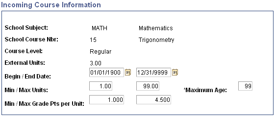

Access the Incoming Course Information page (click the Incoming Course Information link on the Subject Area Elements page).
Image: Incoming Course Information page
This example illustrates the fields and controls on the Incoming Course Information page. You can find definitions for the fields and controls later on this page.
Field or Control
Definition
Begin / End Date
By default, the system populates the begin and end date of the incoming course with 01/01/1900 and 12/31/9999. You can override these default values. These dates inform the Transfer Credit process when this incoming course is valid for the course transfer equivalency rule to which you attach this component subject area.
Min / Max Units (minimum and maximum units)
The system displays the default minimum and maximum units for incoming courses within this component subject area. You can override these default values.
For example, you might want to specify the same incoming course twice but differentiate each specification by how many units are earned. In this case, specify the same incoming course multiple times but with different minimum and maximum unit ranges.
The system displays the default minimum and maximum grade points per unit for incoming courses within this component subject area. You can override these default values.
Maximum Age
This field defines the maximum age in years of the incoming course. This prevents an individual from transferring credit for this course to your academic institution when the individual took the course more years ago than the number that you specify here. By default, the system sets the maximum age of an incoming course to 99 years, but you can override this default value. For instance, you might want restrict individuals from receiving transfer credit for a course when an individual has taken the course more than 4 years previous to the date your institution processes that individual's transfer credit.
Access the Course Transfer Rules page (select Records and Enrollment, then select Transfer Credit Rules, then select Course Transfer Rules, then select Course Transfer Rules).
Image: Course Transfer Rules page
This example illustrates the fields and controls on the Course Transfer Rules page. You can find definitions for the fields and controls later on this page.
For each transfer equivalency rule, attach component subject areas that you have defined for the source in the Transfer Subject Area (TRNSFR_SUBJ_AREA) component. You can define multiple course transfer equivalency rules for a single source. For example, you might define multiple rules to account for academic program and academic plan differences in equivalency rules. The effective date functionality enables you to add and delete component subject areas that are no longer valid for the equivalency rule.
When adding a new transfer equivalency rule, you must also specify the credit source type of either external organization or internal academic institution. The credit source type instructs the system from which table you will select your source ID. By selecting external organization, the system prompts you with the source IDs of external organizations in your system. By selecting institution, the system prompts you with source IDs of academic institutions in your system.
Field or Control
Definition
Enter the component subject areas to tie to the course transfer equivalency rule. Each component subject area defines the incoming courses, their internal equivalent courses, and detail about how the Transfer Credit process must function. The Transfer Credit process uses the transfer component data for component subject areas to determine an individual's transfer credit.
