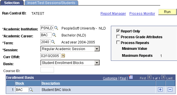

Access the Create Test Sessions - Selection page (select (Records and Enrollment, then select Test Administration NLD, then select Create Test Sessions, then select Selection).
Image: Create Test Sessions - Selection page
This example illustrates the fields and controls on the Create Test Sessions - Selection page. You can find definitions for the fields and controls later on this page.
The Create Test Session SQR process (SRCRESNL) creates the test sessions and enrolls the students based on the criteria that you select on the Create Test Sessions - Selection and Insert Test Sessions/Student pages.
Field or Control
Definition
Basis
Select how the system enrolls students. Values are:
Enrollment in Classes: Select to enroll students who are enrolled in the selected classes into the test sessions.
Student Enrollment Blocks: Select to enroll students into test sessions from an enrollment block.
Student Groups: Select to enroll students into test sessions from a student group.
Course ID
Enter a course ID to select classes by course.
This field is available only when you select Enrollment in Classes in the Basis field.
Report Only
Select to do a test run to determine whether the enrollment will be successful. You are able to view and correct any errors that occur with the your defined criteria before processing the actual enrollment.
Process Grade Attributes
Select to process students that have an exempt grade for the test.
Process Repeats
Select to process repeated sessions.
Minimum Value
Enter the minimum grade value that is allowed for repeats.
Maximum Repeats
Enter the maximum number of repeats that are allowed.
Enrollment Basis
Field or Control
Definition
Block
Enter the enrollment block from which to enroll students. You can insert as many rows as needed.
This field is available only when you select Student Enrollment Blocks in the Basis field.
Class
Enter the class from which you want to enroll students. You can insert as many rows as needed.
Group
Enter the student group from which you want to enroll students. You can insert as many rows as needed.
This field is available only when you select Student Groups in the Basis field.

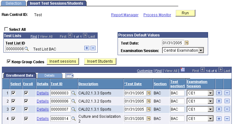

Access the Insert Test Sessions/Students page (select Records and Enrollment, then select Test Administration NLD, then select Create Test Sessions, then select Insert Test Sessions/Students).
Image: Insert Test Sessions/Students page
This example illustrates the fields and controls on the Insert Test Sessions/Students page. You can find definitions for the fields and controls later on this page.
Field or Control
Definition
Select All
Select to choose from all test lists that are created for the academic institution and career combination. If this check box is cleared, you can choose only from the test lists that are associated with the course ID entered on the Selection page.
This check box is available only if you selected Enrollment in Classes as the enrollment basis on the Selection page.
Test List ID
Enter a test list to generate test sessions for the tests in the list. You can add more than one test list.
You can enroll students into test lists if you selected Place or Both in the Test List Use field on the Test List Information page.
Keep Group Codes
Select to create test sessions for each test in the test list for every class, group, or block that you entered on the Create Test Sessions - Selection page. For example, if you entered two classes and the test list contains four tests, selecting this check box would generate eight test sessions. If you clear this check box, the system creates one test session for each test in the test list and calls the session TOT.
Insert Session
Click to insert test sessions from the test list that you selected.
Insert Students
Click to enroll students from the basis on the Selection page.
Test ID
Enter a test or calculated result ID.
Test Date
Enter a default test date for the test sessions.
Examination Session
Select a default examination session for the test sessions that you create. The values are Central Examination 1, Central Examination 2, End Examination 1, End Examination 2, and School Examination.
Enrollment Data
Select the Enrollment Data tab.
Field or Control
Definition
Select
Select to include this row in the Create Test Sessions process.
Enroll
Select to have the Create Test Sessions process enroll students from this row.
Details
Click to view, add, or delete students from the session, and to view messages about the students' enrollment in the session. The Enroll Student in Tests page appears.
Test ID
When you click the Insert Tests button, the system loads the tests from the test list and supplies the test ID. You can add or delete tests by adding or deleting rows.
Description
The description of the test appears.
Test Date
The test date that is entered in the Process Default Values group box appears. You can change this date here.
Section
This comes from the selection page and is based on the selection in the Enrollment Basis grid.
Test Section1
If the Keep Group Codes check box is selected, the system populates this field with the description of the enrollment basis. If the Keep Group Codes check box is cleared, the system names the section TOT; however, you can change it. This value appears in the Test Session pages.
Examination Session
The examination session that is entered in the Process Default Values group box appears. You can change the session if needed. The values are CE1, CE2, EN1, EN2, and SCE.
Details
Select the Details tab.
Field or Control
Definition
Instructor ID
Enter an instructor for the test session.
Facility ID
Enter a facility for the test session.
Meeting Start Time
Enter the time that the meeting is planned to start.
Meeting End Time
Enter the time that the meeting is planned to end.
