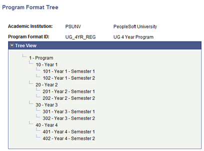

  • Activate Planning Node: Sets the Attempt Status field (on the APT Items page) to Activated for the items representing the planning node and child program format tree nodes. For example, with a program format like this:
    Image: Program Format example for APT (Academic Progress Tracker)
    This example illustrates the fields and controls on the Program Format example for APT (Academic Progress Tracker). You can find definitions for the fields and controls later on this page.
    where Year is the Planning Node, this action would activate the Year and both of its child Semester items. Activation occurs on the current planning node in APT: that is, the maximum sequenced planning node with an attempt status equal to null.

When this option is selected, the APT request process sequentially identifies which planning node should be created for a student. For example, if the student's program format has four planning nodes, 10, 20, 30 and 40 and the action is Create Ins and Plan Node Attempt, the process creates the lowest planning node ID, 10.
