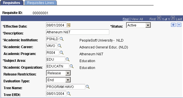

Access the Requisites page (select Records and Enrollment, then select Test Administration NLD, then select Set Up Test Administration, then select Requisites, then select Requisites).
Image: Requisites page
This example illustrates the fields and controls on the Requisites page. You can find definitions for the fields and controls later on this page.
Requisites page
Field or Control
Definition
Academic Program
Enter the academic program to which this requirement applies.
Release Restriction
Indicate whether the grades that are used to satisfy this requisite and that are also restricted can be used in other requisites. Values are:
Keep: Grades used in this requisite that are restricted cannot be used in other requisites.
Release: Restrictions from this requisite are released, so grades used in this requisite can also be used in other requisites.
Evaluation Type
Select the evaluation type of this requisite. Values are:
End: The requisite applies to an end of term evaluation.
In Between: The requisite applies to evaluation milestones during the term.
This field is informational only and is not used in any processing.
Tree Name
Enter the test tree for this requisite. Students who are linked to this test tree are evaluated based on the requisites defined here when you run the Evaluate Students process.
Tree EffDt (tree effective date)
Enter the effective date of the test tree for which you are defining evaluation requisites.

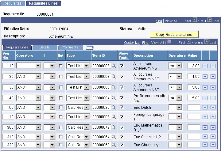

Access the Requisites Lines page (select Records and Enrollment, then select Test Administration NLD, then select Set Up Test Administration, then select Requisites, then select Requisites Lines).
Image: Requisites Lines page
This example illustrates the fields and controls on the Requisites Lines page. You can find definitions for the fields and controls later on this page.
Field or Control
Definition
Copy Requisite Lines
Click to select an already-created requisite to copy. The Copy Requisite Lines page appears.
Requisite Lines Tab
Field or Control
Definition
Seq Nbr (sequence number)
The system increments the sequence numbers by 10 for each line added. The Evaluate Students process evaluates the lines in this requisite in the order established by the sequence numbers. To change the order of the lines, change the sequence numbers.
Operators
If needed, select a Boolean operator to group requirements. The options are AND, AND NOT, OR, and OR NOT.
( (open parenthesis)
Use parentheses to group requirements. You can use up to three levels.
Not
Select if this line must not be true.
Type
Indicate whether this requisite line pertains to a Calc Res (calculated result), Req (requisite), Test, or Test List. You can create a line that pertains to another requisite because you can have nested requirements.
Item ID
Enter a calculated result, test ID, requisite ID, or test list ID, depending on what you selected in the Type field.
Description
The description of the calculated result, test, requisite, or test list.
Operators
Operators enable the system to evaluate grades on a minimum or maximum condition to determine insufficient grades.
For test lists, values are < (less than), <= (less than or equal to), = (equal to), >= (greater than or equal to), and > (greater than).
For calculated results, requisites, and tests, values are > (greater than), = (equal to), and >= (greater than or equal to).
Value
Enter the minimum or maximum value of a grade.

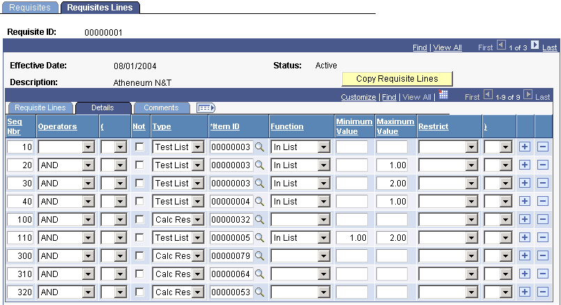

Details Tab
Access the Requisites Lines page: Details tab.
Image: Requisites Lines page: Details tab
This example illustrates the fields and controls on the Requisites Lines page: Details tab. You can find definitions for the fields and controls later on this page.
Field or Control
Definition
Function
Functions are used with test lists, and together with the minimum and maximum values enable you to link conditions to a group of courses, tests, or calculated results such as a minimum or maximum number of tests that a student must pass, or a minimum or maximum number with a specific calculated result.
Values are:
Average: The average of the tests or courses in the list
List: The number of tests or courses that must be in the list.
Sum 1: The sum of Units 1.
Sum 2: The sum of Units 2.
Minimum Value
Enter the minimum number for the selected function.
Maximum Value
Enter the maximum number for the selected function.
Restrict
Designate whether the grades that are used to satisfy this line can be used to satisfy other lines in other requisites. If the grades can be used to satisfy other lines in this requisite, leave the field blank.
Select All Result if the grade used to satisfy this line cannot be used to satisfy other lines. The test or calculated result in this line is blocked for further evaluation within this requisite.
Select Restricted if the grade used to satisfy this line cannot be used to satisfy other lines within this requisite, but can be used to satisfy lines in other requisites. The test or calculated result in this line is blocked for further evaluation within the requisite.
) (close parenthesis)
Select to close group of lines.
