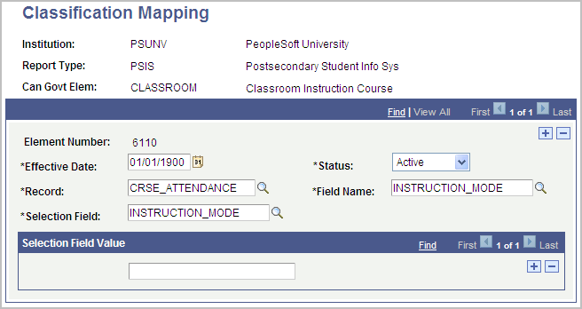

Access the Classification Mapping page (select Records and Enrollment, then select Government Reporting Canada, then select Mapping, then select Classification Mapping Table, then select Classification Mapping).
Image: Classification Mapping page
This example illustrates the fields and controls on the Classification Mapping page. You can find definitions for the fields and controls later on this page.
Values for the Record, Field Name, and Selection Field fields are delivered and defined for all applicable elements for PSUNV. Set up the same values for your institution if you perform PSIS reporting.
Field or Control
Definition
Record
Enter the PeopleSoft record name that the system uses to report the specified element.
Field Name
Enter the PeopleSoft field name that the system uses to report the specified element. The system prompt table displays all valid fields for the record, but does not edit your input against the list. This enables you to enter a field name that is in a subrecord.
Selection Field
Enter the PeopleSoft selection field that applies to the element. This field must be on the record you specify. This field may be the same as or different from the Field Name value.
Selection Field Value
Enter the PeopleSoft selection field values that relate to the selection field that you want to report. You can enter more than one value.
