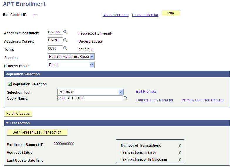

APT Enrollment
SSR_APT_ENR_RUNCNT
select Records and Enrollment, then select Program Enrollment, then select APT Enrollment
Enroll students based on APT course entries.
Access the APT Enrollment page (select Records and Enrollment, then select Program Enrollment, then select APT Enrollment).
Image: APT Enrollment page
This example illustrates the fields and controls on the APT Enrollment page. You can find definitions for the fields and controls later on this page.
APT (Academic Progress Tracker) Enrollment page
The following values determine the keys that are used to fetch rows from the CLASS_TBL for this run and also determine the values that are used as prompts when defining the student population. If the run control values are Institution: PSUNV, Term: 0690, then the Population Selection query (or a manually entered list of students) must use the same values to select rows from APT (SSR_APT_SCHD).
Field or Control
Definition
Academic Institution
Select an Institution value.
Academic Career
Select an Academic Career value.
This value is required for prompting against the TERM_TBL (which is keyed by INSTITUTION, ACAD_CAREER and STRM).
Term and Session
Select a Term and Session value. These values, along with the Institution value are used to fetch rows from the CLASS_TBL.
APT Enrollment can be used to create (and process) enrollment requests or to save classes so that they are accessible for the student to enroll in, using Self Service.
Field or Control
Definition
Process Mode
Enroll: Select this mode to create an Enrollment Request (one request per run) which can be processed directly from this component, or retrieved, adjusted if necessary and posted using the Block Enroll component.
Schedule Builder: If you select this mode, classes are saved directly to the SSR_REGFORM table where the student can retrieve them using the self-service Schedule Builder component to complete the enrollment process.

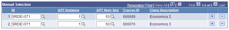

Manual Selection
When the Population Selection check box is cleared, the Manual Selection grid is available for entry:
Image: APT Enrollment – Manual Selection grid
This example illustrates the fields and controls on the APT Enrollment page – Manual Selection grid. You can find definitions for the fields and controls later on this page.
APT (Academic Progress Tracker) Enrollment page Manual Selection grid
Field or Control
Definition
APT Instance
Prompts against a view of the SSR_APT_HDR table for the selected student.
APT Item Seq(sequence)
Prompts against a view of APT Items and returns all items with an item type of COURSE:
  • Where the Term value in the APT Item Attempt Table (SSR_APT_SCHD.STRM) is equal to the Run Control Term value.
  • If the student’s Attempt Schedule contains a session value (that is, the enrollment cohort also records session values) a match is also made on the SSR_APT_SCHD.SESSION_CODE value and the Run Control session value.
See Creating and Managing APT Instances Using the Academic Progress Tracker Component
Course ID and Class Description
The Course ID and Class Description (Subject Catalog Nbr) for the COURSE item are displayed when you use the Fetch Classes button (see the following documentation for Fetch Classes).

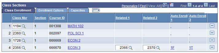

Class Enrollment tab:
Field or Control
Definition
Class Nbr
Displays the CLASS_NBR value for the lowest CLASS_SECTION value with a CLASS_TYPE of E. You can select a different value if other sections are available.
Class Description
Click the Class Description link (SUBJECT and CATALOG_NBR) to access the Class Detail page and view enrollment capacity and totals.
Related 1 and Related 2
Displays the CLASS_NBR value for the lowest CLASS_SECTION value for related components (a maximum of two, neither of which is auto-enroll). You can select different values if they are available.
Auto Enroll 1 and Auto Enroll 2
Click the links to access the Class Detail page and view enrollment capacity and totals.

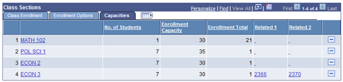

Capacities tab:
Image: APT Enrollment Class Sections grid – Capacities tab
This example illustrates the fields and controls on the APT Enrollment Class Sections grid – Capacities tab.
APT (Academic Progress Tracker) Enrollment page Class Sections grid: Capacities tab
Field or Control
Definition
No. of Students
Displays the total number of students in the selected population that need to be enrolled in the section of this course.
Enrollment Capacity
Displays the enrollment capacity of the selected enrollment section.
Enrollment Total
Displays the current enrollment total for the selected enrollment section.

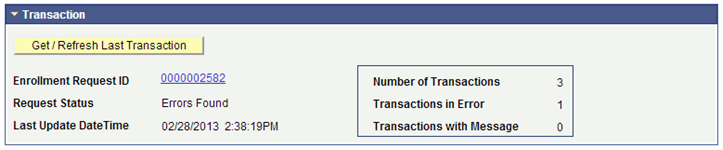

Viewing Transaction Data
View APT Enrollment transaction data in the Transaction group box:
Image: APT Enrollment Transaction group box
This example illustrates the fields and controls on the APT Enrollment Transaction group box. You can find definitions for the fields and controls later on this page.
APT (Academic Progress Tracker) Enrollment Transaction group box
Field or Control
Definition
Get / Refresh Last Transaction
Click to retrieve the last enrollment request generated for this Run Control/User ID (can be used when the same Run Control is used for multiple runs).
Enrollment Request ID
Displays the last enrollment request generated for this Run Control/User ID. An enrollment request is generated only when the Process Mode is Enroll.
Request Status
Displays the status of the Enrollment Request (ENRL_REQ_HEADER.ENRL_REQ_PROC_ST).
Last Update Date Time
Displays the time stamp value for the enrollment request (ENRL_REQ_HEADER.DTTM_STAMP_SEC).
Number of Transactions
Displays the number of Enrollment Request detail rows (the number of Student/Class number combinations within the request).
Transactions in Error
Displays the number of Enrollment Request detail rows that resulted in error (ENRL_REQ_DETAIL.ENRL_REQ_DETL_STAT = E).
Transactions with Message
Displays the number of Enrollment Request detail rows that were processed successfully but for which an informational message was returned (ENRL_REQ_DETAIL.ENRL_REQ_DETL_STAT = M): for example, a student was added to a wait list or a student was enrolled in a class but the repeat check process returned a repeat warning.

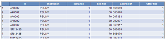

Running the APT Enrollment Process
The Population Selection (or Manual Entry) populates a result table (SSR_APT_ENR_TGT) with the following values returned from the APT Item Attempt table for items where the item type is COURSE and where the APT Item Schedule (SSR_APT_SCHD) term (and session if the enrollment cohort uses session level) match the run control term value:
Image: APT Enrollment Result Table example
This example illustrates the fields and controls on the APT Enrollment Result Table. You can find definitions for the fields and controls later on this page.
APT (Academic Progress Tracker) Enrollment Result Table example
Field or Control
Definition
Institution and Instance
Displays the Institution and Instance values for the selected instance.
Seq Nbr
Displays the SSR_APT_ATT.SSR_APT_ITEM_SEQ value.
Offer Nbr
Displays the Course Offering value if it exists (not required).
