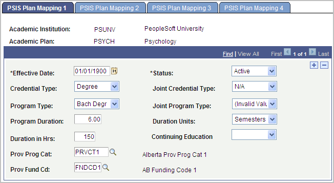

Access the PSIS Plan Mapping 1 page (select Records and Enrollment, then select Government Reporting Canada, then select Academic Structure Tables, then select PSIS Plan Table, then select PSIS Plan Mapping 1).
Image: PSIS Plan Mapping 1 page
This example illustrates the fields and controls on the PSIS Plan Mapping 1 page. You can find definitions for the fields and controls later on this page.
PSIS (Postsecondary Student Information System) Plan Mapping 1 page
Field or Control
Definition
Credential Type
Enter the type of credential the institution awards for successful completion of the program.
Joint Credential Type
Enter the joint or second credential for joint programs in which a student typically receives two credentials.
Program Type
Enter the program type.
Joint Program Type
Enter the type of joint credential the institution awards for successful completion of the program.
Program Duration
Enter the normal time to complete the entire program for a full-time student through traditional program delivery.
Duration Units
Enter the type of time unit you used to calculate program duration. Values are Acad Years, Half - Semes, Months, NA, Semesters, Weeks, and Years.
Duration in Hrs (duration in hours)
Enter the sum of the hours of instruction of courses normally required to complete the entire program through traditional delivery.

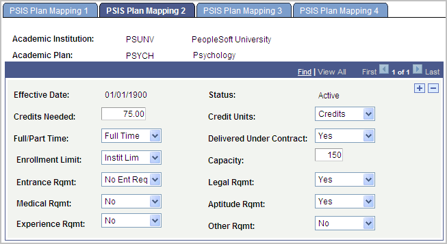

Access the PSIS Plan Mapping 2 page (select Records and Enrollment, then select Government Reporting Canada, then select Academic Structure Tables, then select PSIS Plan Table, then select PSIS Plan Mapping 2).
Image: PSIS Plan Mapping 2 page
This example illustrates the fields and controls on the PSIS Plan Mapping 2 page. You can find definitions for the fields and controls later on this page.
PSIS (Postsecondary Student Information System) Plan Mapping 2 page
Field or Control
Definition
Credits Needed
Enter the number of credits or units of academic achievement required to complete the program.
Credit Units
Enter the type of units used in the Credits Needed field. The system populates this field by default from the Business Unit table.
Full/Part Time
Indicate whether the program is offered on a full-time basis (FT), part-time basis (PT), or at the student's option (FT/PT).
Delivered Under Contract
Indicate whether the program is delivered under contract by the institution to an outside party. Values are N/A, No, Unknown, and Yes.
Enrollment Limit
Indicate whether the program is limited, either by an internally or externally imposed quota. Values are Govt Limit, Instit Lim, N/A, No, Prof Org, and Unknown.
Capacity
If the program has limited enrollment, enter the maximum number of new students that can be admitted to the program during a report period.
Entrance Rqmt (entrance requirement)
Enter the educational entrance requirements to begin the program. Values are N/A, No, Unknown, and Yes.
Legal Rqmt (legal requirement)
Indicate whether any legal requirements exist for the program. Values are N/A, No, Unknown, and Yes.
Medical Rqmt (medical requirement)
Indicate whether any medical or psychological entrance requirements exist for the program. Values are N/A, No, Unknown, and Yes.
Aptitude Rqmt (aptitude requirement)
Indicate whether successful completion of an aptitude and proficiency test (or interview) is an entrance requirement for the program. Values are N/A, No, Unknown, and Yes.
Experience Rqmt (experience requirement)
Indicate whether previous related experience is an entrance requirement for the program. Values are N/A, No, Unknown, and Yes.
Other Rqmt (other requirement)
Indicate whether any other entrance requirements are required for entry into the program. Values are N/A, No, Unknown, and Yes.

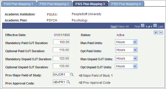

Access the PSIS Plan Mapping 3 page (select Records and Enrollment, then select Government Reporting Canada, then select Academic Structure Tables, then select PSIS Plan Table, then select PSIS Plan Mapping 3).
Image: PSIS Plan Mapping 3 page
This example illustrates the fields and controls on the PSIS Plan Mapping 3 page. You can find definitions for the fields and controls later on this page.
PSIS (Postsecondary Student Information System ) Plan Mapping 3 page
Field or Control
Definition
Mandatory Paid OJT Duration (mandatory paid on the job training duration)
Enter the duration of mandatory paid on the job training (OJT) activities that are a regular part of the program.
Man Paid Units (mandatory paid units)
Enter the unit type for the Man Paid OJT Duration field. The system populates this field by default from the Business Unit table. The system populates a value of N/A if you do not enter a duration value.
Optional Paid OJT Duration (optional paid on the job training duration)
Enter the duration of optional paid on the job training (OJT) activities that are a regular part of the program.
Opt Paid Units (optional paid units)
Enter the unit type for the Optional Paid OJT Duration field. The system populates this field by default from the Business Unit table. The system populates a value of N/A if you do not enter a duration value.
Mandatory Unpaid OJT Duration (mandatory unpaid on the job training duration)
Enter the duration of mandatory unpaid on the job training (OJT) activities that are a regular part of the program.
Man Unpaid OJT Units (mandatory unpaid on the job training units)
Enter the unit type for the Mandatory Unpaid OJT Duration field. The system populates this field by default from the Business Unit table. The system populates a value of N/A if you do not enter a duration value.
Optional Unpaid OJT Duration (optional unpaid on the job training duration)
Enter the duration of optional unpaid on the job training (OJT) activities that are a regular part of the program.
Opt Unpaid OJT Units (optional unpaid on the job training units)
Enter the unit type for the Optional Unpaid OJT Duration field. The system populates this field by default from the Business Unit table. The system populates a value of N/A if you do not enter a duration value.

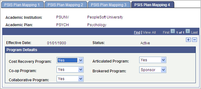

Access the PSIS Plan Mapping 4 page (select Records and Enrollment, then select Government Reporting Canada, then select Academic Structure Tables, then select PSIS Plan Table, then select PSIS Plan Mapping 4).
Image: PSIS Plan Mapping 4 page
This example illustrates the fields and controls on the PSIS Plan Mapping 4 page. You can find definitions for the fields and controls later on this page.
PSIS (Postsecondary Student Information System) Plan Mapping 4 page
Field or Control
Definition
Cost Recovery Program
Indicate whether the program is a cost recovery program.
Articulated Program
Indicate whether, on completion of the credits for the program, the student is entitled to advanced standing in a target program in another institution with which the reporting institution has an articulation agreement.
Co-op Program
Indicate whether this is a co-op program.
Brokered Program
Indicate whether the program is a brokered program.
Collaborative Program
Indicate whether the program is offered under a collaborative agreement, whereby two or more institutions share ownership or responsibility for the program and each delivers part of the program.

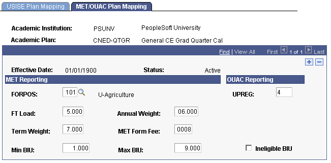

Access the MET/OUAC Plan Mapping page (select Records and Enrollment, then select Government Reporting Canada, then select Academic Structure Tables, then select Academic Plan Table CDN, then select MET/OUAC Plan Mapping).
Image: MET/OUAC Plan Mapping page
This example illustrates the fields and controls on the MET/OUAC Plan Mapping page. You can find definitions for the fields and controls later on this page.
MET/OUAC (Ministry of Education and Training / Ontario Universities Application Center) Plan Mapping page
Field or Control
Definition
FORPOS (formula program of study)
Enter the government code that represents the formula program of study.
UPREG (university and program registration)
Enter the government code that represents the university and program in which the applicant registers.
FT Load
Enter the full time load for an academic program and plan as the institution defines it.
Annual Weight
Established by MET and based on the FORPOS code. Weight varies for diploma and degree programs. Weights also differ from one institution to another for institution specific FORPOS codes.
Term Weight
Enter a value that the system uses when calculating the annual business income unit (BIU) for graduate levels.
Met Form Fee
Established by MET, based on the FORPOS code.
Min BIU (minimum business income unit)
Enter the minimum BIU that a graduate student can generate for an institution. This is independent of the actual number of years that the individual requires to complete his or her program of study.
Max BIU (maximum business income unit)
Enter the maximum BIU that a graduate student can generate for an institution. This is independent of the actual number of years that the individual requires to complete his or her program of study.
Ineligible BIU (ineligible business income unit)
Select this check box to indicate the academic program and plan is ineligible and the system should therefore not include it in the calculation of FTE (full time equivalency).
