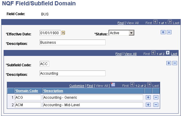

Access the NQF Field/Subfield Domain page (select Set Up SACR, then select Product Related, then select Student Records, then select Curriculum Management, then select NQF Field/Subfield Domain NZL, then select NQF Field/Subfield Domain).
Image: NQF Field/Subfield Domain page
This example illustrates the fields and controls on the NQF Field/Subfield Domain page. You can find definitions for the fields and controls later on this page.
NQF (National Qualification Framework) Field/Subfield Domain page
Field or Control
Definition
Field Code
When setting up a new field, enter an NZQA defined field code.
Subfield Code
Enter an NZQA-defined subfield code.
You can enter as many subfield codes as needed for this field.
Domain Code
Enter an NZQA-defined domain code.
You can enter as many domain codes as needed for each subfield.
