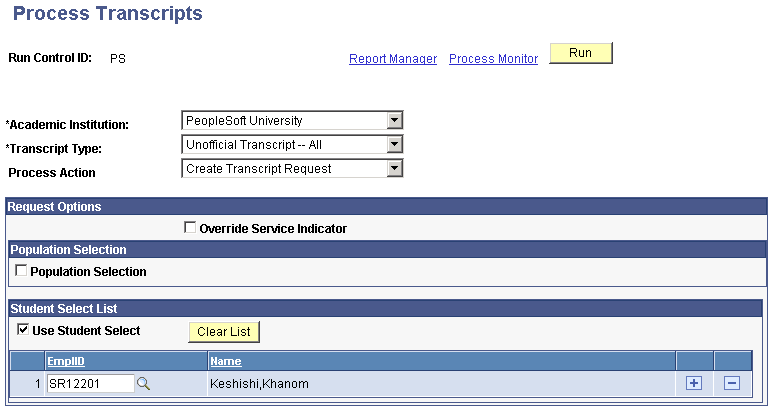

Access the Process Transcripts page (select Records and Enrollment, then select Transcripts, then select Batch Transcripts, then select Process Transcripts).
Image: Process Transcripts page
This example illustrates the fields and controls on the Process Transcripts page. You can find definitions for the fields and controls later on this page.
Note: The fields on this page change based on the Process Action that you select.
Field or Control
Definition
Academic Institution
Select the institution for which the transcript type is associated. When you run the process, the system creates a transcript request number for each row within the process instance. Institution values are defined on the Academic Institution Table page.
Transcript Type
Select the transcript type. Be sure you select a transcript type with the correct detail organization that you want to appear on the transcripts. You can organize by academic career or chronology. Transcript type values are defined on the Define Transcript Type - Basic Data page.
Process Action
Select one of these options: Create Transcript Request, Generate Transcript, Generate and Print Transcript, Print Transcript, or Request, Generate and Print.
If you select a Process Action of Generate Transcript or Generate and Print Transcript, the system finds all transcripts that have an On Request status (requested only).
If you select a Process Action of Print Transcript, the system finds all transcripts that have a Completed status (generated), but have not yet printed.
To reprint a previously printed transcript, select the Reprint check box. This check box is available only when you select a Process Action of Print Transcript.
Note: If you select the Allow XML Output File check box on the Define Transcript Type - Basic Data page, the Output XML File and Output File Path fields appear on this page when you select a value of Generate and Print Transcript, Print Transcript, or Request, Generate and Print in the Process Action field.
Override Service Indicator
Select this check box to override any service indicators attached to student records that may prevent a transcript from being generated.
Population Selection
This group box appears if you select the Create Transcript Request or Request, Generate and Print process action.
Population selection is a method for selecting the IDs to process for a specific transaction. The Population Selection group box is a standard group box that appears on run control pages when the Population Selection process is available or required for the transaction. Selection tools are available based on the selection tools that your institution selected in the setup of the Population Selection process for the application process and on your user security. Fields in the group box appear based on the selection tool that you select. The fields behave the same way from within the group box on all run control pages and application processes.
If your institution uses a specific delivered selection tool (PS Query, Equation Engine equation, or external file) to identify IDs for a specific transaction, you must use it.
See Understanding the Population Selection Group Box
See Using the Population Selection Process

Student Select List
This group box appears if you select the Create Transcript Request or Request, Generate and Print process action. Select the Use Student Select check box to add individual student IDs to your batch transcript process request. You can use this method alone or in combination with the Population Selection process to create the batch request.
Field or Control
Definition
EmplID (employee ID)
Enter individual student IDs that you want to include in the batch transcript request. The student's name appears to the right of this field.
Clear List
Click this button to remove all entered names from the student list.
