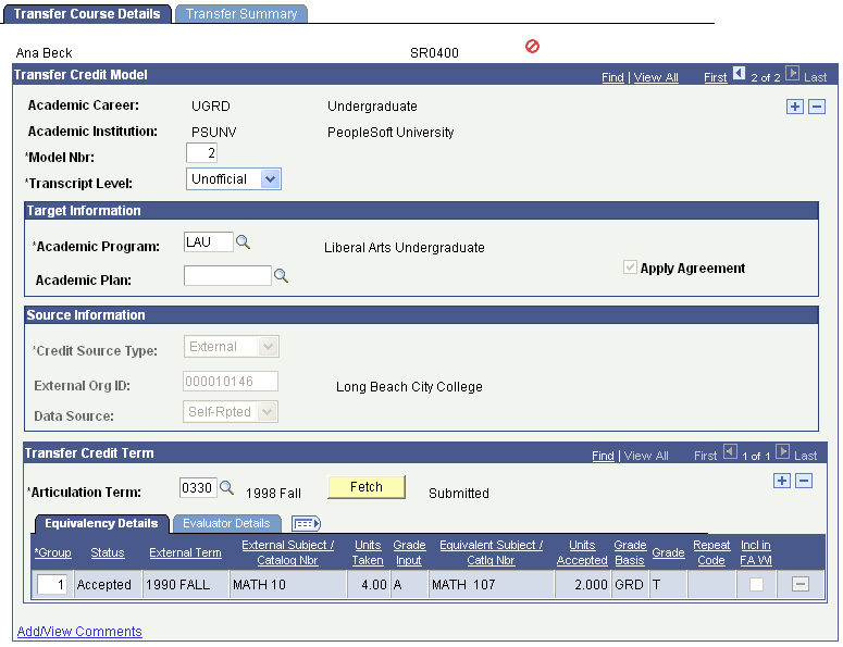

Transfer Course Details
TRNS_CRSE_DTL
select Records and Enrollment, then select Transfer Credit Evaluation, then select Course Credits - Automated, then select Transfer Course Details
Create course transfer credit models and run the Transfer Credit process to evaluate the models. For each model, you specify target information, source information, and the articulation term. Then you run the Transfer Credit process to articulate course transfer credit, using predefined equivalency rules. You can revise the results as necessary.

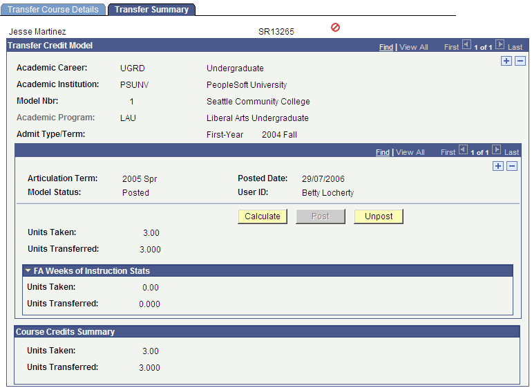

Transfer Summary
TRNS_CRSE_TERM
select Records and Enrollment, then select Transfer Credit Evaluation, then select Course Credits - Automated, then select Transfer Summary
Calculate an individual's transfer credit statistics, based on the accepted internal equivalent courses of a transfer credit model. After you view the statistics for the transfer credit model, you can post the transfer credit to an individual's record. You can also use this page to unpost transfer credit.

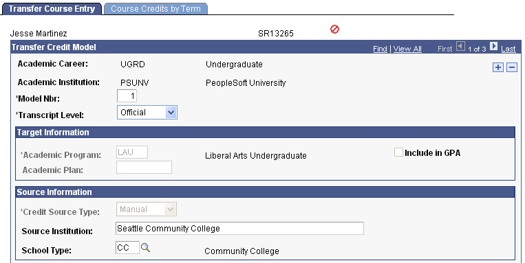

Transfer Course Entry
TRNS_CRSE_ENTRY
select Records and Enrollment, then select Transfer Credit Evaluation, then select Course Credits - Manual, then select Transfer Course Entry
Set up course transfer credit models and articulate transfer credit manually as you set up models rather than by using predefined equivalency rules. This page is essentially the same as the Transfer Course Details page of the Course Credits component with the few exceptions that are described in this section.

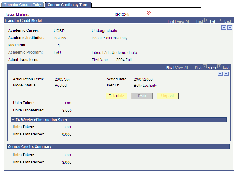

Course Credits by Term
TRNS_CRSE_TERM
select Records and Enrollment, then select Transfer Credit Evaluation, then select Course Credits - Manual, then select Course Credits by Term
Calculate an individual's transfer credit statistics for a model based on the accepted internal equivalent courses of the model. After you view the statistics for the transfer credit model, you can post the transfer credit to an individual's record. You can also use this page to unpost transfer credit. This is the same page as the Transfer Summary page of the course credits component.

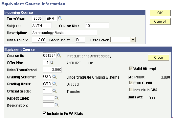

Equivalent Course Information
TRNS_CRSE_INT_SEC
Click the Edit Equivalent Course button on the Transfer Course Details page to edit equivalent course information.
Click the Add Internal Equivalent button on the Transfer Course Details page to enter additional equivalent courses.
View incoming course credit information for a specific row of a course transfer credit model, and view and edit equivalent course information.

Access the Transfer Course Details page (select Records and Enrollment, then select Transfer Credit Evaluation, then select Course Credits - Automated, then select Transfer Course Details).
Image: Transfer Course Details page
This example illustrates the fields and controls on the Transfer Course Details page. You can find definitions for the fields and controls later on this page.
Field or Control
Definition
Apply Agreement
Select to have the Transfer Credit process use the agreement equivalency rule selected for the specified academic program, plan, and source combination on the Rules Specification page. Clear this check box to ignore the specified agreement equivalency rule. By default, the system selects this check box.
(AUS) Level of Education
This mandatory field appears only if the school type assigned to the credit has a DEST credit basis of 0200 Credit Offered for Prior VET Study.
School types are defined on the School Type Table page.
This field appears only if the DEST, HECS, Centrelink, TAC check box is selected on the SA Features page.
(AUS) DEST Institution
Note: This field is available only if you select the Australia DEST, HECS, Centrelink, TAC check box on the Academic Institution 6 page.
Enter the DIISRTE institution code from which the transfer credit is coming.
Department of Industry, Innovation, Science, Research and Tertiary Education (DIISRTE) was previously known as DEEWR and before that, as DEST.
Fetch
After you have selected an articulation term for this row of the course transfer credit model, click this button to run the Transfer Credit process.
The Transfer Credit process COBOL program evaluates the individual's course transfer credit according to the valid course transfer equivalency rules. The process determines valid course transfer equivalency rules for the specified source based on whether the rule is active previous to the begin date of the articulation term and based on whether the rule was attached to the individual's academic program or academic plan for the specified source. The process then compares the individual's external course information to the valid rules and calculates the results. The courses that the process evaluates appear in the grid at the bottom of the page.
Define course transfer equivalency rules on the Transfer Subject Area component and attach them to academic programs and academic plans for the source on the Program/Source Equivalency component. Enter an individual's external course information on the External Courses page of the Education component.
External Term
After you run the Transfer Credit process for this row of the model, the process displays the external term of each course that it evaluated. The process determines the external term for the transfer course according to the value that is entered for the course in the corresponding field on the External Courses page of the Education component.
External Subject/Catalog Nbr (external subject/catalog number)
After you run the Transfer Credit process for this row of the model, the process displays the external subject and catalog number of each course that it evaluated. The process determines the external subject and catalog number for the transfer course according to the value that is entered for the course in the corresponding fields on the External Courses page of the Education component.
Note: When you post a model, the Source Information group box for that row becomes unavailable.
Note: Using the column heading links to sort data on this page may ungroup external and equivalent courses.

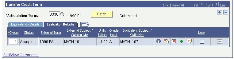

Evaluator Details
Select the Evaluator Details tab.
Image: Transfer Course Details page: Evaluator Details tab
This example illustrates the fields and controls on the Transfer Course Details page: Evaluator Details tab. You can find definitions for the fields and controls later on this page.
See the previous Common Elements section for information about the icons on this tab.
Access the Transfer Summary page (select Records and Enrollment, then select Transfer Credit Evaluation, then select Course Credits - Automated, then select Transfer Summary).
Image: Transfer Summary page
This example illustrates the fields and controls on the Transfer Summary page. You can find definitions for the fields and controls later on this page.
Field or Control
Definition
Calculate
After you articulate course credit, click this button to calculate the individual's transfer credit statistics according to the accepted transfer credit on the corresponding row of the model.
Note: When you post the transfer credit without clicking the Calculate button, the process still calculates the units.
If you selected to include the accepted equivalent courses of this model in the individual's GPA and you have transferred grades that include grade points, the system calculates the transfer taken for GPA, the transfer passed for GPA, the transfer grade points, and the transfer GPA.
If you selected to include the accepted equivalent courses of this model in the individual's GPA and you transferred grades that are not included in, for example, F grade points, the system calculates the transfer taken not for GPA and the transfer passed not for GPA.
If you have not selected to include the accepted equivalent courses of this model in the individual's GPA, the system calculates the units taken and the units transferred.
You can select to include transfer credit in the GPA for external organizations and internal academic institutions on the Organization Affiliation page.

Access the Transfer Course Entry page (select Records and Enrollment, then select Transfer Credit Evaluation, then select Course Credits - Manual, then select Transfer Course Entry).
Image: Transfer Course Entry page (1 of 2)
This example illustrates the fields and controls on the Transfer Course Entry page (1 of 2). You can find definitions for the fields and controls later on this page.
Image: Transfer Course Entry page (2 of 2)
This example illustrates the fields and controls on the Transfer Course Entry page (2 of 2). You can find definitions for the fields and controls later on this page.
Target Information
Field or Control
Definition
Include in GPA (include in grade point average)
Select to include eligible courses within this model in students' GPA totals and No GPA totals at your academic institution. Clear this check box to include the eligible courses as units only.
Eligible courses are those courses with the Include in GPA check box selected on the Equivalent Course Information page. Conversely, ineligible courses are those with the Include in GPA check box cleared on the Equivalent Course Information page.
The system renders the Include in GPA field on this page unavailable when the model is posted.
Note: The Include in GPA check box in the Target Information group box has no impact on the Academic Advisement engine. The Academic Advisement engine looks at the Include in GPA check box on the Equivalent Course Information page to evaluate course grade points for academic requirements and enrollment requisites.
Source Information

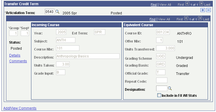

Field or Control
Definition
Transfer Credit Term
Field or Control
Definition
Details
Click to access the Equivalent Course Information page, where you can edit equivalent course information prior to posting transfer credit.
Comments
Click to access the Course Credit Comments page, where you can add an override reason and comment about any adjustments that you have made to this row of the model.
Incoming Course
Use the Incoming Course group box to define your external course information for this row of the transfer credit model.
Field or Control
Definition

Access the Course Credits by Term page (select Records and Enrollment, then select Transfer Credit Evaluation, then select Course Credits - Manual, then select Course Credits by Term).
Image: Course Credits by Term page
This example illustrates the fields and controls on the Course Credits by Term page. You can find definitions for the fields and controls later on this page.
