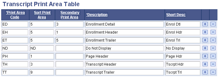

Access the Transcript Print Area Table page (select Set Up SACR, then select Product Related, then select Student Records, then select Transcript, then select Transcript Print Area Table, then select Transcript Print Area Table).
Image: Transcript Print Area Table page
This example illustrates the fields and controls on the Transcript Print Area Table page. You can find definitions for the fields and controls later on this page.
Field or Control
Definition
Print Area Code
An acronym that defines the transcript print area.
Sort Print Area, Secondary Print Area
The values in these fields determine how the system sorts the print areas on the transcript.
Description
Text used on the Define Transcript Type component to determine print detail.
Short Desc (short description)
Value used internally by system processes. Not visible on any pages.
