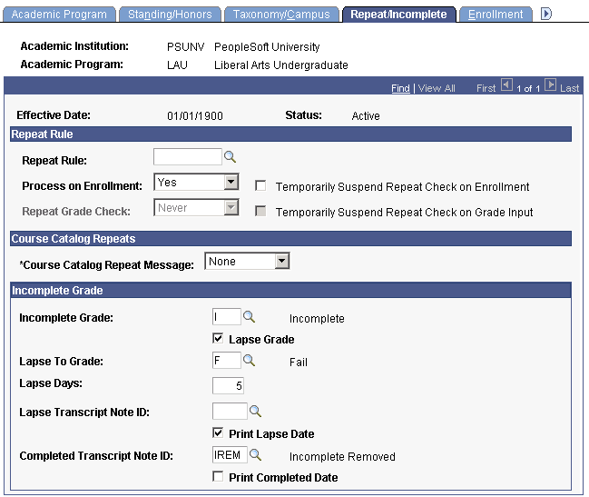

Access the Repeat/Incomplete page (select Set Up SACR, then select Foundation Tables, then select Academic Structure, then select Academic Program Table, then select Repeat/Incomplete).
Image: Repeat/Incomplete page
This example illustrates the fields and controls on the Repeat/Incomplete page. You can find definitions for the fields and controls later on this page.
Field or Control
Definition
Incomplete Grade
Enter a value that you define as an incomplete grade for students who are active in this program. This grade lapses to the value in the Lapse To Grade field as a result of the Grade Lapse process only if you select the Lapse Grade check box. If you neither select the Lapse Grade check box nor enter a Lapse To Grade value, then the system never lapses the incomplete grade. Grade values are defined on the Grading Scheme Table page.
Lapse Grade
Select to use the lapse grade rules for this incomplete grade. Some incomplete grades may not have lapse rules attached to them (in which case you would leave the Lapse To Grade field blank.) If you do not select this check box, the system does not change incomplete grades to any lapse grade value for classes taken in this academic program, and the lapse transcript note ID does not appear.
Lapse To Grade
Select the lapse to grade value. Grade values are defined on the Grading Scheme Table page.
Lapse Days
Enter the number of days past the fully-graded date that an incomplete grade can stay on a student's record. This value is provided by default from the Term Calendar 3 page to the student career term record during term activation. Lapse days function as a grace period.
For example, assume that at PSUNV the fully-graded date for the undergraduate academic career (UGRD), term 0330, regular session (1) is 12/01/01.
If the institutional policy at PSUNV for the LAU academic program allows a student to make up incomplete grades for one month past the term's end, you would enter 30 in the Lapse Days field. When you run the Grade Lapse process, use 1/10/02 as the lapse deadline. This way, you can be sure that all students who might make up an incomplete have done so and that the grades have been entered and posted. The additional 10 days provide you with time to post grades.
Note: Run the grade lapse report after all grades are entered and posted, which can be after your lapse day's deadline.
Lapse Transcript Note ID
Select the transcript note ID for the lapse grade. Transcript note IDs are defined on the Transcript Note Table page.
Print Lapse Date
Select to display the lapse date on the student's transcript. The system uses the lapse days value to generate the lapse date. It does not use the lapse process date.
Completed Transcript Note ID
Select the transcript note ID that appears after the student's final grade is posted. Transcript note IDs are defined on the Transcript Note Table page.
Print Completed Date
Select to display the completed date on the student's transcript.
