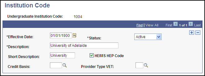

Access the Institution Code page (select Set Up SACR, then select Product Related, then select Student Records, then select Enrollment Reporting Codes, then select AUS Regulatory Report Setup, then select Institution Code, then select Institution Code).
Image: Institution Code page
This example illustrates the fields and controls on the Institution Code page. You can find definitions for the fields and controls later on this page.
These codes are provided by DIISRTE. Set up codes for all your institutions, and for institutions from which you receive transfer students.
Field or Control
Definition
Credit Basis
Enter the value to be reported for DIISRTE Element 561 Credit-Basis, if the institution code is assigned to manual course credits processed for a student.
This field appears only if the DEST, HECS, Centrelink, TAC check box is selected on the SA Features page.
Provider Type VET
Enter the value to be reported for DIISRTE Element 564 Provider Type, if the institution code is assigned to manual course credits processed for a student.
This field is optional. If the institution does not offer VET related study, you do not have to enter a value.

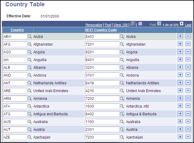

Access the Country Code Table page (select Set Up SACR, then select Product Related, then select Student Records, then select Enrollment Reporting Codes, then select AUS Regulatory Report Setup, then select Country Code Table, then select Country Code Table).
Setting up the country codes for DIISRTE reporting requires that you enter the DIISRTE country codes into your system, then map each DIISRTE country code to the appropriate country code defined in the system. Map country codes to DIISRTE country codes on the Country Table page.
Access the Country Table page (select Set Up SACR, then select Product Related, then select Student Records, then select Enrollment Reporting Codes, then select AUS Regulatory Report Setup, then select Country Table, then select Country Table).
Image: Country Table page
This example illustrates the fields and controls on the Country Table page. You can find definitions for the fields and controls later on this page.
Country Table page
Note: Set up DIISRTE country code values on the Country Code Table page.
Field or Control
Definition
Country
Select a PeopleSoft defined country code.
DEST Country Code
Enter the equivalent DIISRTE defined country code.

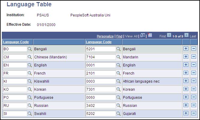

Access the Language Code Table page (select Set Up SACR, then select Product Related, then select Student Records, then select Enrollment Reporting Codes, then select AUS Regulatory Report Setup, then select Language Code Table, then select Language Code Table).
Setting up the language codes for DIISRTE reporting requires that you enter the DIISRTE language codes into your system, then map each DIISRTE language code with the appropriate language code in the system. Map language codes to DIISRTE language codes on the Language Table page.
Access the Language Table page (select Set Up SACR, then select Product Related, then select Student Records, then select Enrollment Reporting Codes, then select AUS Regulatory Report Setup, then select Language Table, then select Language Table).
Image: Language Table page
This example illustrates the fields and controls on the Language Table page. You can find definitions for the fields and controls later on this page.
Language Table page
Note: Set up DIISRTE language code values on the Language Code Table page.
Field or Control
Definition
Language Code (on left.)
Select a PeopleSoft defined language code.
Language Code (on right.)
Enter the equivalent DIISRTE language code.

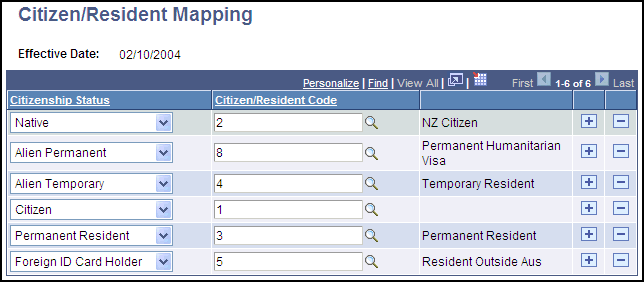

Access the Citizen/Res Indicator page (select Set Up SACR, then select Product Related, then select Student Records, then select Enrollment Reporting Codes, then select AUS Regulatory Report Setup, then select Citizen/Res Indicator, then select Citizen/Res Indicator).
DIISRTE citizenship and residency codes are provided by DIISRTE. Map citizenship codes to DIISRTE citizen/resident codes on the Citizen/Resident Mapping page.
Access the Citizen/Resident Mapping page (select Set Up SACR, then select Product Related, then select Student Records, then select Enrollment Reporting Codes, then select AUS Regulatory Report Setup, then select Citizen/Resident Mapping, then select Citizen/Resident Mapping).
Image: Citizen/Resident Mapping page
This example illustrates the fields and controls on the Citizen/Resident Mapping page. You can find definitions for the fields and controls later on this page.
Note: Set up DIISRTE citizenship and resident code values on the Citizen/Res Indicator page.
Field or Control
Definition
Citizenship Status
Select a PeopleSoft defined citizenship status code.
Citizen/Resident Code
Enter the equivalent DIISRTE citizen/resident code.

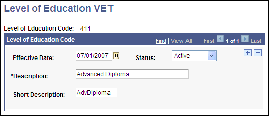

Access the Level of Education VET page (select Set Up SACR, then select Product Related, then select Student Records, then select Enrollment Reporting Codes, then select AUS Regulatory Report Setup, then select Level of Education VET, then select Level of Education VET).
Image: Level of Education VET page
This example illustrates the fields and controls on the Level of Education VET page. You can find definitions for the fields and controls later on this page.
Level of Education VET (Vocational Education and Training) page
Use this page to enter values for DEST Element 563 – Level of Education for Prior VET Study.
These values are then available in the Level of Education field on the Transfer Course Entry page, if the school type assigned to the credit has a DEST Credit Basis of 0200 Credit Offered for Prior VET Study.
