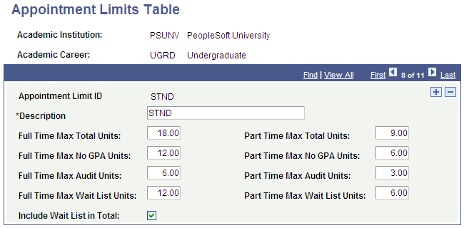

Access the Appointment Limits Table page (select Records and Enrollment, then select Term Processing, then select Appointments, then select Appointment Limits Table, then select Appointment Limits Table).
Image: Appointment Limits Table page
This example illustrates the fields and controls on the Appointment Limits Table page. You can find definitions for the fields and controls later on this page.

Appointment Limit ID
Enter an appointment limit ID for every group at your academic institution that has varied enrollment unit restrictions. For example, each appointment limit ID that you define might have different full-time and part-time maximum and minimum units.
Full Time Max Total Units and Part Time Max Total Units
Enter the maximum number of units that a full-time and part-time student can enroll in during the specified enrollment appointment.
Full Time Max No GPA Units (full time maximum number grade point average units) and Part Time Max No GPA Units (part time maximum number grade point average units)
Enter the maximum number of units that a full-time and part-time student can enroll in with a non-GPA grading basis during the specified enrollment appointment.
Full Time Max Audit Units and Part Time Max Audit Units
Enter the maximum number of units that a full-time and part-time student can audit during the specified enrollment appointment.
Full Time Max Wait List Units and Part Time Max Wait List Units
Enter the maximum number of wait-list units that a full-time and part-time student can take during the specified enrollment appointment.
Include Wait List in Total
If you select this check box, the enrollment engine includes wait listed units towards the appointment maximum.
For example: A student has an appointment maximum unit limit of 18 and a maximum wait list unit limit of 12. The student is enrolled in 6 units and wait listed in 6 units. If the check box is selected, the student can enroll and/or wait list in an additional 6 units only, because the 6 wait listed units are applied to the overall limit of 18.
Example
For example, the registrar at PSUNV wants to create enrollment appointments on a ranking basis: seniors with a higher GPA enroll first, then seniors with a lower GPA. This same pattern works down to the freshman level. Graduate students can enroll any time. In addition, PSUNV limits the number of units in which a freshman can enroll. All other undergraduates require the same unit limit.
At least two appointment limit codes are required to represent the variable maximum units. In our example, it is not necessary to create an appointment code for graduate students because they can enroll at any time and because we have set the open enrollment date early enough on the Session Table page for the graduate academic career. Thus, we would create one appointment limit ID for freshman that specifies the appropriate unit limits, and a second appointment limit ID for all other undergraduates that specifies the appropriate unit limits. The mass enrollment appointment process handles the GPA ranking.
