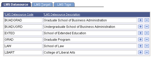

Access the LMS Datasource page (select Curriculum Management, then select Learning Management Systems, then select LMS System Setup, then select LMS Datasource).
Image: LMS Datasource page
This example illustrates the fields and controls on the LMS Datasource page. You can find definitions for the fields and controls later on this page.
LMS (Learning Management System) Datasource page
LMS datasource codes and descriptions are required on the LMS Batch Extract page as part of your run control parameters if you run the batch extract process with an LMS batch extract file type of XML V1.1. If you run the batch extract process with an LMS extract file type of Blackboard CourseInfo 4 or API Input format, this setup is not required.
Field or Control
Definition
LMS Datasource Code and LMS Datasource Description
Enter an LMS datasource code and corresponding LMS datasource description for all valid data sources. The data source is an identifier for the site generating the XML file and is used in the properties object (header record).
For XML file types, the LMS datasource code must be entered at runtime on the LMS Batch Extract - Setup page.

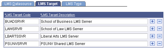

Access the LMS Target page (select Curriculum Management, then select Learning Management Systems, then select LMS System Setup, then select LMS Target).
Image: LMS Target page
This example illustrates the fields and controls on the LMS Target page. You can find definitions for the fields and controls later on this page.
LMS (Learning Management System) Target page
LMS target code and description information is required on the LMS Batch Extract - Setup page as part of your run control parameters if you run the batch extract process with an LMS type of XML V1.1. If you run the batch extract process with an LMS extract file type of Blackboard CourseInfo 4 or API Input format, this setup is not required.
Field or Control
Definition
LMS Target Code and LMS Target Description
Enter an LMS target code and corresponding LMS target description for all valid recipients of the XML files. The target code is an identifier for the site receiving the XML file and is used in the properties object (header record).
For XML file types, the LMS target code is entered at runtime on the LMS Batch Extract - Setup page.

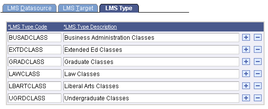

Access the LMS Type page (select Curriculum Management, then select Learning Management Systems, then select LMS System Setup, then select LMS Type).
Image: LMS Type page
This example illustrates the fields and controls on the LMS Type page. You can find definitions for the fields and controls later on this page.
LMS (Learning Management System) Type page
LMS type and description information is required on the LMS Batch Extract - Setup page as part of your run control parameters if you run the batch extract process with an LMS type of XML V1.1. If you run the batch extract process with an LMS extract file type of Blackboard CourseInfo 4 or API Input format, this setup is not required.
Field or Control
Definition
LMS Type Code and LMS Type Description
Enter an LMS type code and a corresponding LMS type description to specify the nature of any extract that you may perform with this type. The type code is used in the properties object (header record).
For XML types, the LMS type code is entered at runtime on the LMS Extract - Setup page.
