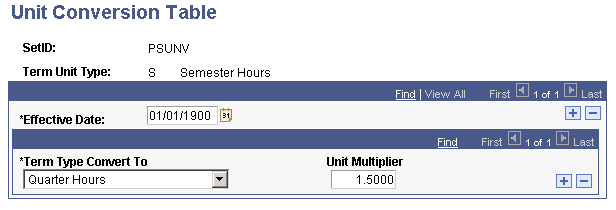

Access the Unit Conversion Table page (select Set Up SACR, then select Product Related, then select Student Records, then select Enrollment, then select Unit Conversion Table, then select Unit Conversion Table).
Image: Unit Conversion Table page
This example illustrates the fields and controls on the Unit Conversion Table page. You can find definitions for the fields and controls later on this page.
Field or Control
Definition
Term Type Convert To
Select the value to which you want to convert the value in the Term Unit Type field.
Unit Multiplier
Enter the number for the system to use to multiply the term unit type units by to convert them to the term type convert to value, for example, (term unit type units) × (unit multiplier) = (term type convert to units).
