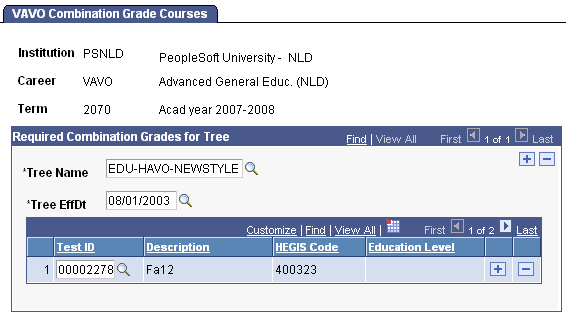

Access the VAVO Combination Grade Courses page (select Records and Enrollment, then select Test Administration NLD, then select Set Up Test Administration, then select VAVO Combination Grade Courses, then select VAVO Combination Grade Courses).
Image: VAVO Combination Grade Courses page
This example illustrates the fields and controls on the VAVO Combination Grade Courses page. You can find definitions for the fields and controls later on this page.
VAVO (Voortgezet Algemeen Volwassenen Onderwijs) Combination Grade Courses page
Field or Control
Definition
Tree Name
Select a validated Test Administration Test Tree value.
Tree EffDt (tree effective date)
Select a validated Test Administration Tree effective date.
Test ID
Test ID values contain EN test level tests from the values that you select in the Tree Name and Tree EffDt fields.
