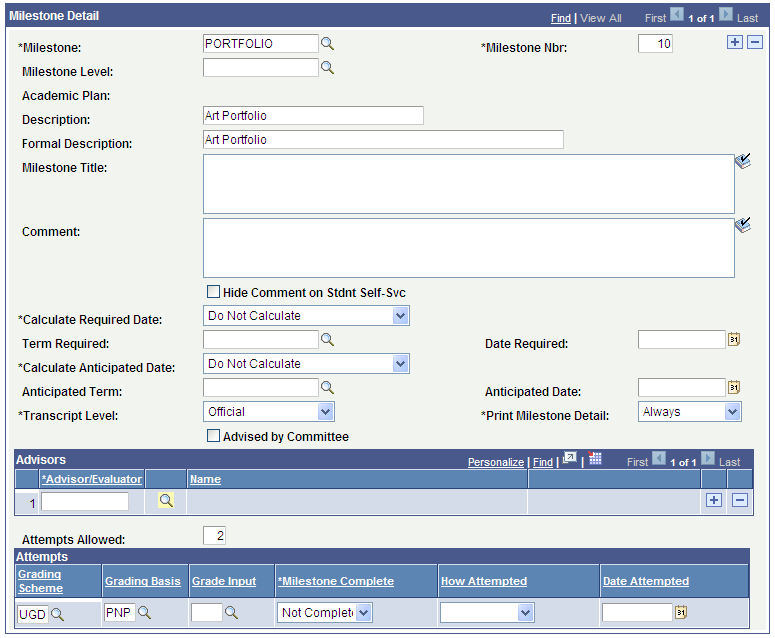

Access the Student Milestones page (select Records and Enrollment, then select Enroll Students, then select Student Milestones, then select Student Milestones).

Milestone Detail
Field or Control
Definition
Milestone Nbr (milestone number)
The milestone number default is 10. As you insert rows, the system increments this number sequentially. The milestone number is used for sequencing.
Milestone Level
Select the milestone level. Some milestones, such as Comprehensive Exams, can have multiple levels. You can override this value.
Milestone Complete
The system displays the milestone complete status according to the values entered in the Attempts grid.
Academic Plan
Select the academic plan to which the milestone is attached. The system prompts you from the student's academic record.
Milestone Title
Enter a title for the milestone. You can print the title on the student's transcript.
Manage Milestone Documents
Attach documents related to the milestone.
Hide Comment on Stdnt Self-Svc
If you select this check box, comments do not appear on the Student Milestone Details page in Student Self Service.
Term Required and Term Anticipated
Select the term by when the milestone must be completed or by when you anticipate the student will complete the milestone.
Depending on the value that is entered in the Calculate Required Date and Calculate Anticipated Date fields on the Milestone Table page – for example, Expected Grad Term Start Date, a value may appear in the Term Required and Term Anticipated fields by default. You can override the value.
Date Required and Anticipated Date
If you select a term, the system populates this date based on the term Ending Date value on the Term Table page. Alternatively, the date appears based on the Milestone Table setup as explained previously. You can override the date.
Print Milestone Detail
Indicates when the milestone is printed on the transcript. The system transfers this value from the Milestone Template page. You can override this value. Values for this field are delivered with your system as translate values. The delivered values are Always, Never, and Satisfied.
Advised by Committee
Select to assign an advisory committee to the student. When you select this check box the Committee field appears.
Advisors
Field or Control
Definition
Advisor/Evaluator
If you do not select the Advised by Committee check box, select individual advisors for the student. The system prompts you with advisors that are within the student's academic career and academic program.
Attempts: Grade Information
Field or Control
Definition
Attempts Allowed
The system displays the attempts allowed according to the values entered on the Milestone Template page. You can override this value.
Attempt Nbr (attempt number)
Enter the number of the student's attempt at this milestone.
Grading Scheme and Grading Basis
The system populates the grading scheme and grading basis from the Milestone Template page. You can override these values.
Grade Input
Enter a grade (if required by the grading scheme and grading basis).
Milestone Complete
Select the status of the milestone. Values for this field are delivered with your system as translate values. You can modify these values. The delivered values are Completed, In Progress, and Not Completed.
How Attempted
Select how the milestone was attempted. Values for this field are delivered with your system as translate values. You can modify these values. The delivered values are Attended Seminar, Exam Taken, Filed Petition, Native Speaker, and Submitted Work.
Date Attempted
Enter the date that the student attempted the milestone.
