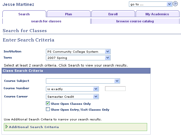

Here is an example of the self-service Search for Classes page:
Image: Example of the Search for Classes page
This example illustrates the fields and controls on the Search for Classes page. You can find definitions for the fields and controls later on this page.

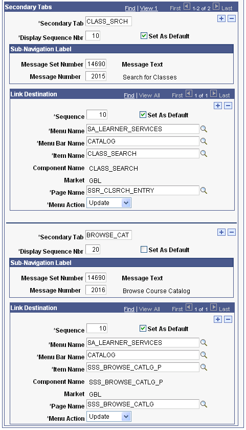

You can see how the text in the Message Text fields on the setup page correspond to the tab names in Self Service.
The Search tab has the lowest sequence number in the Main Tabs group box on the setup page and therefore appears first in Self Service. Similarly, the search for classes tab appears before the browse course catalog tab because of the sequencing of the secondary tabs on the setup page.
When students access the Search tab, the search for classes tab appears by default because the Set as Default check box is selected for that tab on the setup page.

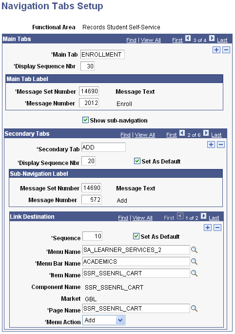

Here are the setup steps:
  1. On the Navigation Tabs Setup page (for Student Records), select ENROLLMENT in the Main Tab field in the Main Tabs group box.
  2. In the Secondary Tabs group box, select ADD in the Secondary Tab field.
  3. In the Link Destination group box, select SA_LEARNER_SERVICES_2 in the Menu Name field.
    Note: Two rows exist in this group box. Ensure that you select SA_LEARNER_SERVICES_2 in both rows.
  4. Click Save.
Here is an example of the setup for the add tab using SA_LEARNER_SERVICES_2:
Image: Example of setup for the add tab using SA_LEARNER_SERVICES_2
This example illustrates the fields and controls on the Navigation Tabs Setup page. You can find definitions for the fields and controls later on this page.

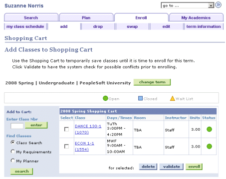

The add tab in Self Service uses the version of the component with the Select check box:
Image: Example of the add tab in Student Center
This example illustrates the fields and controls under the add tab in Student Center. You can find definitions for the fields and controls later on this page.
If you select SA_LEARNER_SERVICES in the Link Destination group box, the Select check box does not appear on the add tab in Self Service. The check box appears only on the shopping cart tab.
You can use the Message Catalog (PeopleTools, Utilities, Administration, Message Catalog) to change the title text that appears on the add and shopping cart tabs. The existing text appears on the previous example page.
