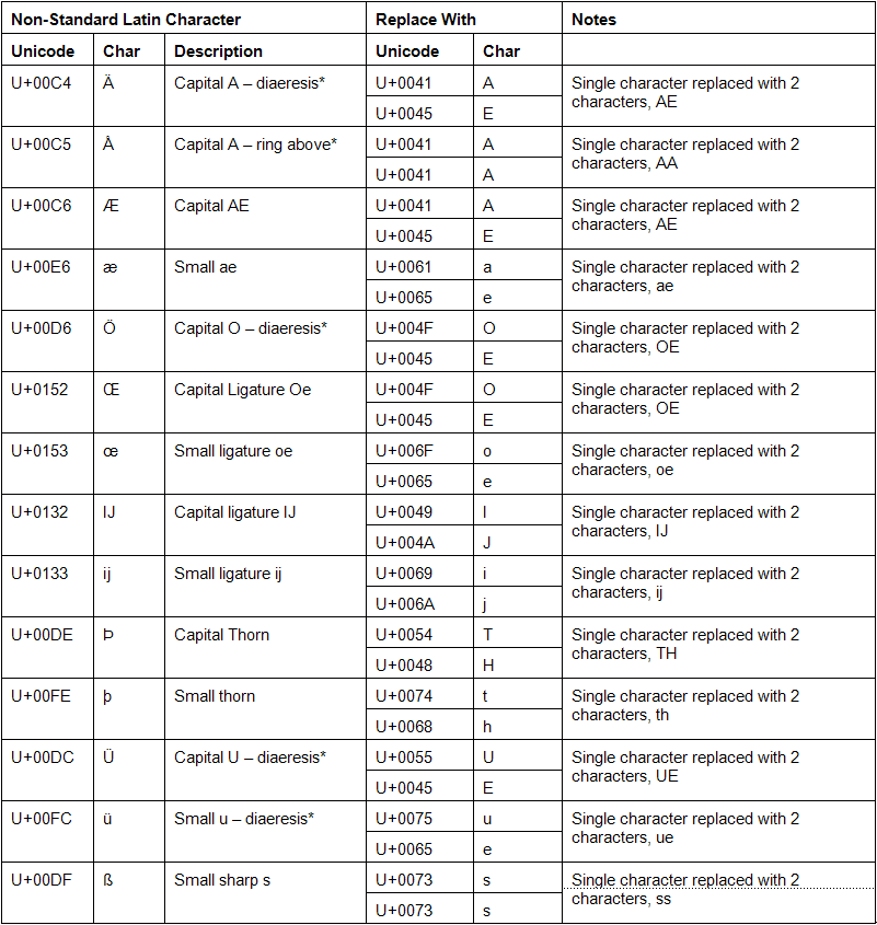

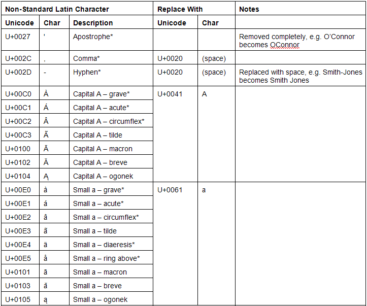

Image: Character Conversion for Punctuation Marks; Capital and Small A
This table illustrates the Character Conversion for Punctuation Marks; Capital and Small A.

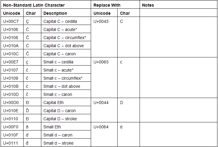

Image: Character Conversion for C and D
This illustrates the Character Conversion for C and D.

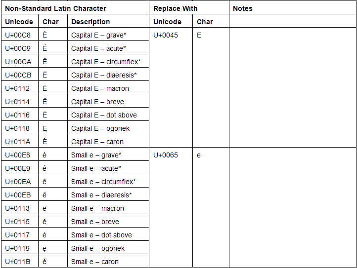

Image: Character Conversion for Capital and Small E
This illustrates the Character Conversion for Capital and Small E.

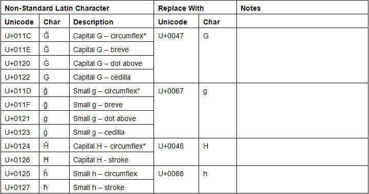

Image: Character Conversion for Capital and Small G; Capital and Small H
This illustrates the Character Conversion for Capital and Small G; Capital and Small H.

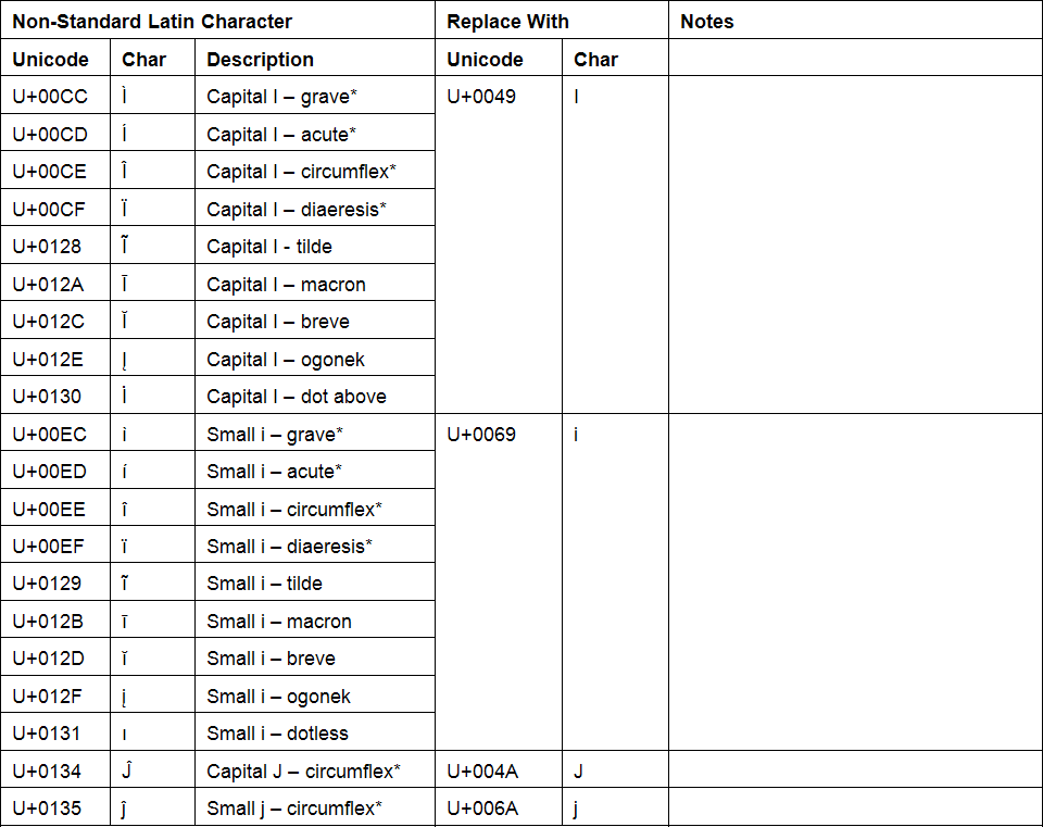

Image: Character Conversion for Capital and Small I; Capital and Small J
This illustrates the Character Conversion for Capital and Small I; Capital and Small J.

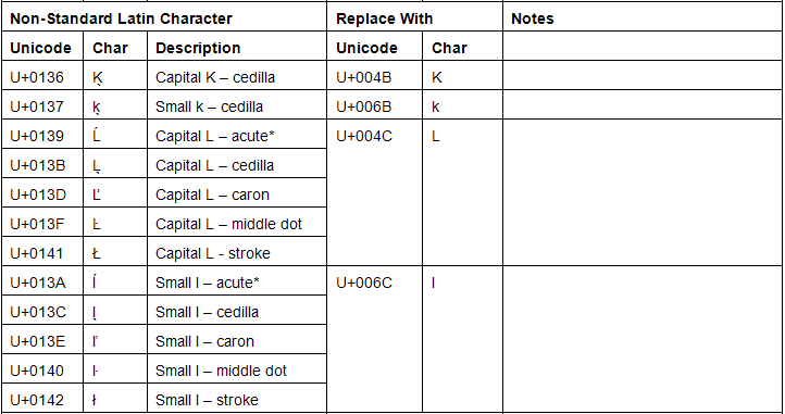

Image: Character Conversion for Capital and Small K; Capital and Small L
This illustrates the Character Conversion for Capital and Small K; Capital and Small L.

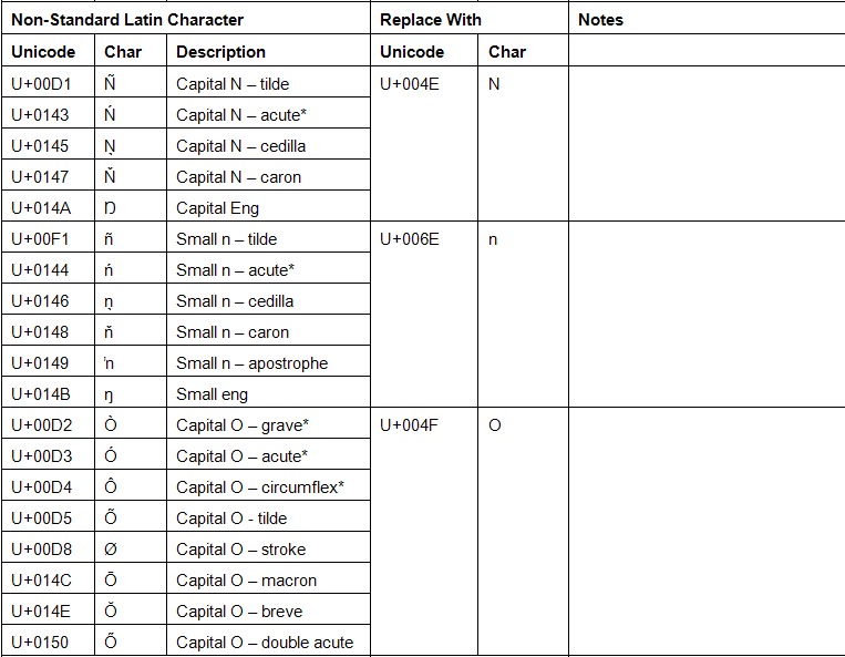

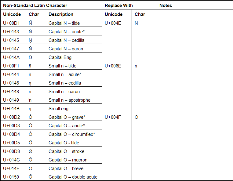

Image: Character Conversion for Capital and Small N; Capital O
This illustrates the Character Conversion for Capital and Small N; Capital O.

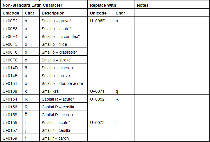

Image: Character Conversion for Small O; Small Q; Capital and Small R
This illustrates the Character Conversion for Small O; Small Q; Capital and Small R.

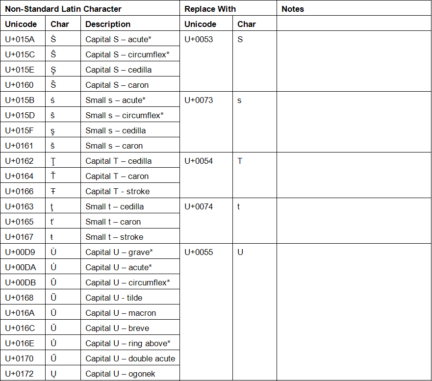

Image: Character Conversion for Capital and Small S; Capital and Small T; Capital U
This illustrates the Character Conversion for Capital and Small S; Capital and Small T; Capital U.

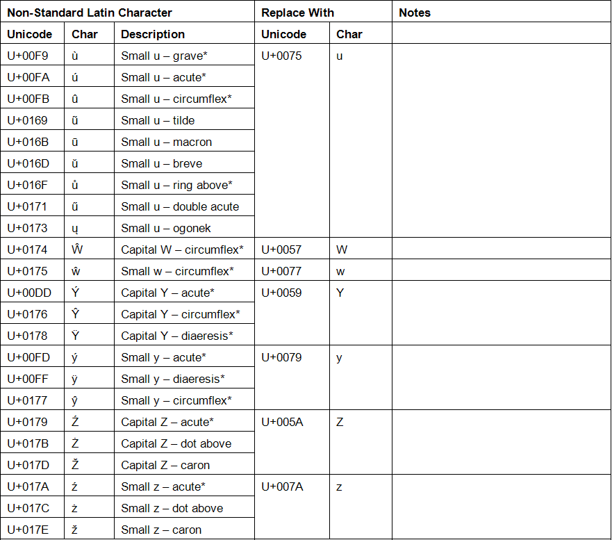

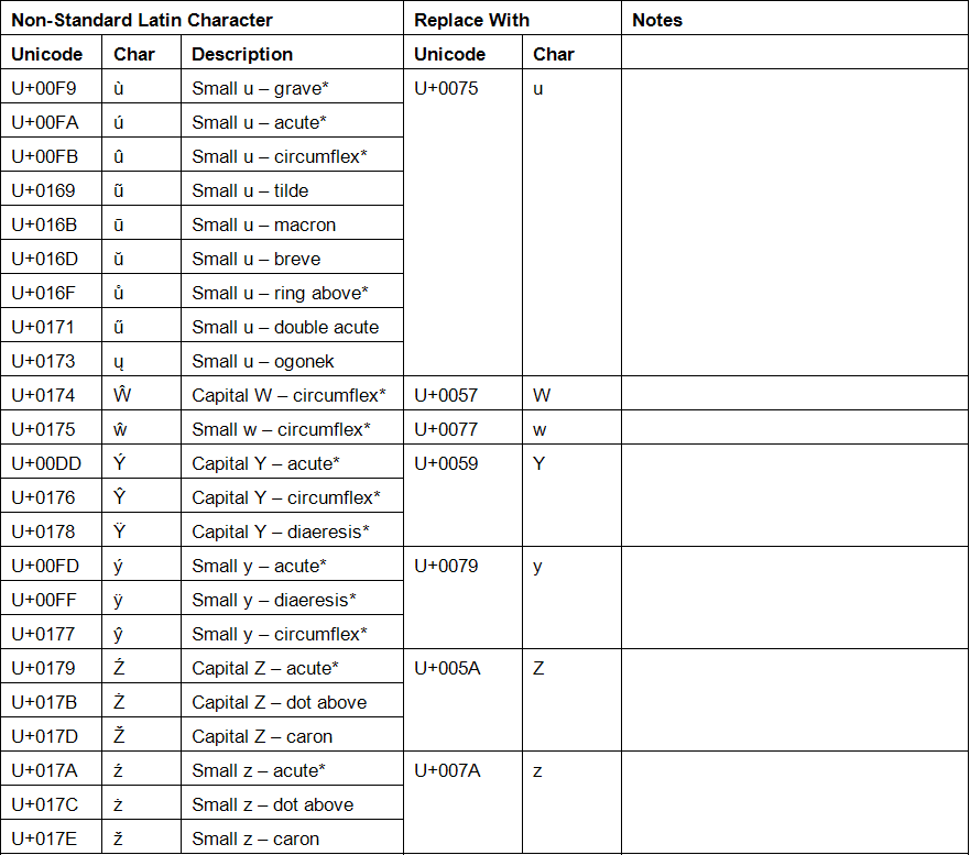

Image: Character Conversion for Small U; Capital and Small W; Capital and Small Y; Capital and Small Z
This illustrates the Character Conversion for Small U; Capital and Small W; Capital and Small Y; Capital and Small Z.
