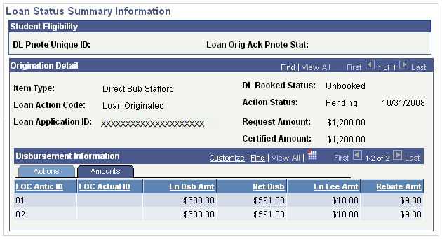

Access the Loan Status Summary Information page (click the Loan Status Summary link on any Direct Loan page with an available link).
Image: Loan Status Summary Information page
This example illustrates the fields and controls on the Loan Status Summary Information page. You can find definitions for the fields and controls later on this page.
Loan Status Summary Information Page (Direct Loan) Actions tab

Origination Detail
Field or Control
Definition
Item Type
Displays the financial aid item type associated with this loan.
Loan Action Code
Displays the most recent loan origination action for the loan. For example, Loan Origination, Loan Origination Change, and so on.
Loan Application ID
Displays the unique ID that the Origination process generated for this loan. The loan application ID is comprised of the following elements:
  • Student's social security number.
  • A single-character code identifying the type of loan (Subsidized, Unsubsidized, PLUS).
  • A two-character code identifying the aid year.
  • Direct Loan school code.
  • A 3-digit sequence number, which is incremented by one each time the student receives an additional loan of the same type.
DL Booked Status (direct lending booked status)
Displays Booked if the origination, first disbursement, and promissory notes are accepted and acknowledged by the COD. Until this occurs, the status is Unbooked.
Action Status
Displays the current status of the action. The values are: Accepted, Ac-NtApld (accepted-not applied), Authorized, Failed, Invalid, Pending, Received, Rejected, and Transmitted. The Action Status for an Acknowledgement is always Received. If an origination or origination change is rejected, the system creates a new loan originated row to track the re-submission of the failed/rejected action.
Request Amount
Displays the amount derived from the accepted amount on the award and is equal to the scheduled disbursement amount.
Certified Amount
Displays the amount approved for the loan. This value is derived from the offer amount on the award.
Actions Tab
Field or Control
Definition
Disb ID (disbursement ID)
Displays the Disbursement ID defined within the Disbursement Plan and Split Code assigned to the Direct Loan Award from Packaging.
LOC Antic ID (loan origination center replaced by common origination and disbursement anticipated [disbursement] ID)
Displays the sequentially ordered ID for the anticipated disbursement. The system converts the Disbursement ID that comes from the award and the anticipated disbursement date defined in the Disbursement ID setup to assist in defining the disbursement sequencing requirements. The LOC Antic ID represents the Disbursement Number for anticipated disbursements (Disbursement Release Indicator set to 'false). The LOC Antic ID may change if additional disbursements are added. However, once an associated LOC Actual ID has been assigned, the LOC Antic ID does not change.
LOC Actual ID
Displays the numerically ordered disbursement ID, without skipping numbers. The LOC Actual ID represents the Disbursement Number for actual disbursements (Disbursement Release Indicator set to 'true').
Action Code
Describes the type of disbursement action for that row.
Action Status
Displays the status for this disbursement ID. See the description of the Action Status field above for more details.
(unlabeled)
Indicates the date of the disbursement action.
Amounts Tab
Select the Amounts tab.
Image: Loan Status Summary Information page: Amounts tab
This example illustrates the fields and controls on the Loan Status Summary Information page: Amounts tab. You can find definitions for the fields and controls later on this page.
Loan Status Summary Information Page (Direct Loan) Amounts tab
Field or Control
Definition
Ln Dsb Amt (loan disbursement amount)
Displays the gross scheduled disbursement amount. This value is derived from the accepted balance on the loan award.
Net Disb (net disbursement)
Displays the amount derived from the loan amount minus the loan fee amount plus the rebate amount.
Ln Fee Amt (loan fee amount)
Displays the calculated loan fee for this disbursement.
Rebate Amt (rebate amount)
Displays the calculated rebate amount for this disbursement.
