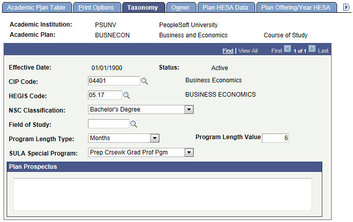

Access the Taxonomy page (select Set Up SACR, then select Foundation Tables, then select Academic Structure, then select Academic Plan Table, then select Taxonomy).
Image: Taxonomy page
This example illustrates the fields and controls on the Taxonomy page. You can find definitions for the fields and controls later on this page.
Taxonomy page
Note: For National Student Clearinghouse (NSC) reporting, program level data is sourced from the Academic Plan Table. You must enter a value in the following fields: CIP Code, NSC Classification, Program Length Type, Program Length Value, and SULA Special Program.
See:
Setting Up For NSC Program Level Reporting
Understanding Consolidate Academic Statistics Process Calculations
Producing NSC Extracts
Field or Control
Definition
CIP Code (Classification of Institutional Programs code)
Enter the CIP code for this academic plan. CIP codes are delivered with the system as translate values. You can modify CIP codes on the CIP Code Table page.
HEGIS Code (Higher Education General Information Survey code)
Enter the HEGIS code for this academic plan. HEGIS codes are delivered with the system as translate values. You can modify HEGIS codes on the HEGIS Code Table page.
NSC Classification (National Student Clearinghouse Classification)
Enter a NSC Classification. NSC Classification values are delivered with the system as translate values.
The system uses this value to derive a Class/Credential Level for each student in the NSC enrollment extract.
Note: If you enter a value of Bachelor's Degree here, you must also enter a value (for example Sophomore) in the NSC Level Category field on the Academic Level Table page.
See Defining Academic Level and Load Rules.
Field of Study
Enter a field of study for the academic plan.
Report as NSC Program
Select to identify a plan as one that should be reported as a program for NSC reporting purposes. When this check box is selected, all related NSC fields (CIP Code, NSC Classification, Program Length Type/Value, SULA Special Program) must have values.
Program Length Type
Select the unit of time you want to use to define the Program Length: Weeks, Months, or Years.
Enter the number of weeks, months, or years for the length of the Program.
SULA Special Program (Subsidized Usage Limit Applies special program)
Select a SULA Special Program. Values include:
  • 2-year Bachelor's Degree (two-year bachelor's degree) – A bachelor's degree program that requires an associate degree or the successful completion of at least two years of postsecondary coursework as a prerequisite for admission into the program.
  • Non-Cred Teacher Cert Pgm (non-credential teacher certification program) – A program that does not lead to a degree/certificate at an institution but leads to a State credential required for teaching.
  • Not Applicable – Not applicable.
  • Prep Crsewk Grad Prof Pgm (preparatory coursework graduate program) – Enrollment in preparatory coursework necessary for enrollment in a graduate or professional program.
  • Prep Crsewk Ugrad Program (preparatory coursework undergraduate program) – Enrollment in preparatory coursework necessary for enrollment in an undergraduate or professional program.
  • Selective Admission Assoc Degree (selective admission associate degree) – An associate’s degree program that:
    1. Requires an associate degree or the successful completion of at least two years of postsecondary coursework as a prerequisite for admission.
    2. Admits only a selected number of applicants based on additional competitive criteria which may include entrance exam scores, class rank, grade point average, written essays, or recommendation letters.
    3. Provides the academic qualifications necessary for a profession that requires licensure or certification by the State in which the coursework is offered.
Note: If this field is left blank, and the corresponding field is also blank in on a student’s FA Term record, then the field on the student’s FA Term is populated in the following ways:
1. FA Term Build (online and batch) populates this field as "Not Applicable".
2. The SULA Application Engine Request process populates this field as "Not Applicable".
3. Manual updates to the FA Term > Statistics page auto-populate this field as "Not Applicable".
See Setting Up 150 Percent Direct Subsidized Loan Limit (SULA).

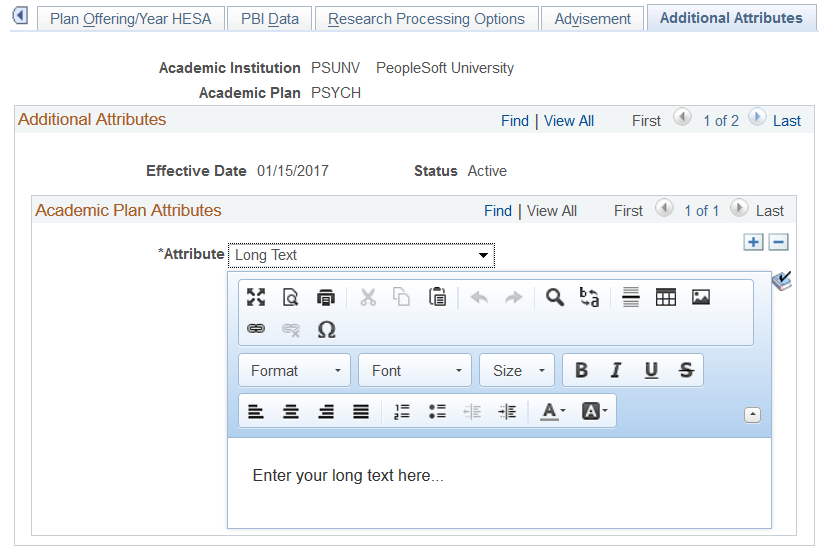

Access the Additional Attributes page (select Set Up SACR, then select Foundation Tables, then select Academic Structure, then select Academic Plan Table, then select Additional Attributes).
Image: Additional Attributes page
This is an example of an attribute that can be used on the Additional Attributes page.
Additional Attributes (Academic Plan) page
Use this page to enter and review Common Attribute fields associated with the academic plan.
The Academic Plan Table CAF record (ACAD_PLAN_CAF) is delivered and associated with the Academic Plan Table (ACAD_PLAN_TBL) record.
This page appears only after adding common attributes to the Academic Plan CAF Table attribute record using the record context (CSS_CAF_REC_ATTRIBUTE) component.
Note: On the Record Context page, you must select the Inline Subpage option in the Attribute Display Type group box. The other option, Secondary Page, is not a supported display type for attributes associated with the Academic Plan Table.
See Defining a Common Attribute.
See Associating a Common Attribute to a Record.
