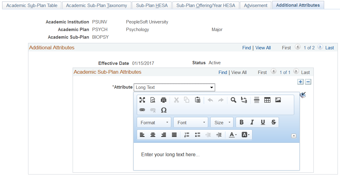

Access the Additional Attributes page (select Set Up SACR, then select Foundation Tables, then select Academic Structure, then select Academic SubPlan Table, then select Additional Attributes).
Image: Additional Attributes page
This is an example of an attribute that can be used on the Additional Attributes page.
Additional Attributes (Academic Sub-Plan) page
Use this page to enter and review Common Attribute fields associated with the academic subplan.
The Academic Subplan CAF Table record (ACAD_SUBPLAN_CAF) is delivered and associated with the Academic Plan Table (ACAD_SUBPLN_TBL) record.
This page appears only after adding common attributes to the Academic Subplan CAF Table attribute record using the record context (CSS_CAF_REC_ATTRIBUTE) component.
Note: On the Record Context page, you must select the Inline Subpage option in the Attribute Display Type group box. The other option, Secondary Page, is not a supported display type for attributes associated with the Academic Subplan Table.
See Defining a Common Attribute.
See Associating a Common Attribute to a Record.
