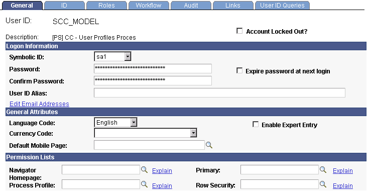

Access the User Profiles - General page (select PeopleTools, then select Security, then select User Profiles, then select User Profiles, then select General).
Image: User Profiles - General page
This example illustrates the fields and controls on the User Profiles - General page. You can find definitions for the fields and controls later on this page.
Add a new value to create a user ID or used the delivered example called SCC_MODEL.
Note: The Account Locked Out functionality is not cloned for the user profiles created in batch. When the user profiles are created, they are ready for the self-service users to access the site.
The system clones these fields to create these user profiles: Symbolic ID, Language Code, Navigator Homepage, Process Profile, Primary, and Row Security.
You should always select a symbolic ID, regardless of the role for which you are running the process. For example, if you are running the process using the role Prospects and you believe the role does not need a symbolic ID, then consider that when prospects become applicants or students, they do need a symbolic ID. There is no background process to create one.
Enter a password and confirm it. These fields are required on this page, but the system does not clone the password when you create the new user IDs.

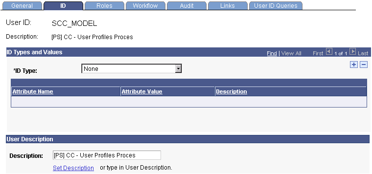

Access the User Profiles - ID page (select PeopleTools, then select Security, then select User Profiles, then select User Profiles, then select ID).
Image: User Profiles - ID page
This example illustrates the fields and controls on the User Profiles - ID page. You can find definitions for the fields and controls later on this page.
The system uses none of the fields on this page during the User Profiles Management process. However, the component requires an ID type. Select an ID type of None. This value is not cloned by the User Profiles Management process. Use the User Profiles Mass Creation setup page to set up the ID type to use for the user profiles that you create.

User Description
Field or Control
Definition
Description
Enter the name for the model user ID.
Note: You do not need to enter any other fields than the ones described when you create the model user ID to be used by the User Profiles Management process. None of the fields on this page are cloned.
