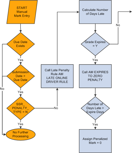

The existence of the Late Penalty Option Inclusion Record on any Assessment Item, along with a submission date that is later than a due date, triggers the Rules Engine to run the AM Late Penalty Online Driver Rule. The rule may call additional expert-level rules for additional calculation. The system then inserts a late penalty result into the student’s result record SSR_IAM_RESULT. Late penalty rows are used in the primary result type calculation. The late penalty inclusion data is setup on the following components: Activity Definition, Activity Registry, Activity Manager, and the Individual Activity Manager.

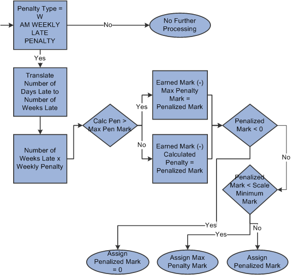

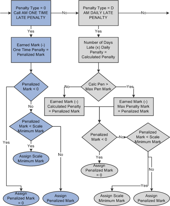

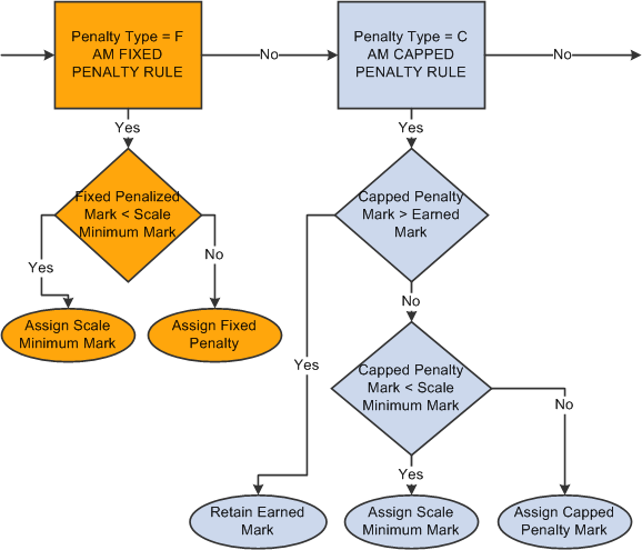

Late Penalty Processing
The late penalty options defined on the Activity Registry include penalizing based on number of days or weeks late with a minimum limit, or subtracting a one-time penalized mark. Users can indicate that a late mark should be capped or fixed at a specific mark. You can also choose to not calculate a penalty. All penalties allow for a mark to be set to 0.0 after a specified amount of time.
The following diagrams outline the processing that generates the late penalty calculations.
Image: Late Penalty Processing (1 of 4)
Diagram 1 of 4 illustrating late penalty processing:
Image: Late Penalty Processing (2 of 4)
Diagram 2 of 4 illustrating late penalty processing:
Image: Late Penalty Processing (3 of 4)
Diagram 3 of 4 illustrating late penalty processing:
Image: Late Penalty Processing (4 of 4)
Diagram 4 of 4 illustrating late penalty processing:

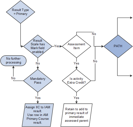

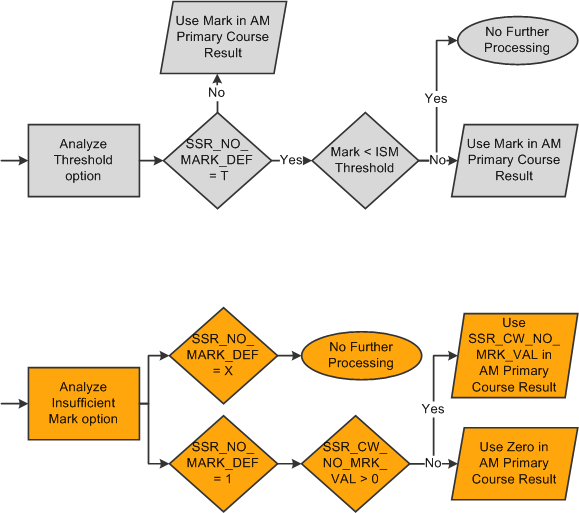

The following diagrams outline the primary result calculation.
Image: Primary Result Type Entity Coding (1 of 3)
Diagram 1 of 3 illustrating primary result calculation:
Image: Primary Result Type Entity Coding (2 of 3)
Diagram 2 of 3 illustrating primary result calculation:
Image: Primary Result Type Entity Coding (3 of 3)
Diagram 3 of 3 illustrating primary result calculation:

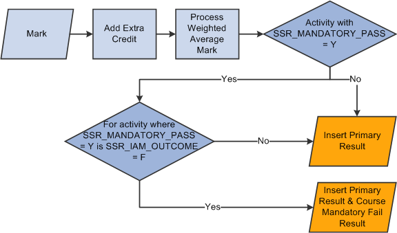

Result Calculation:
Summary Page row selected for Select for Calculation.
and
Result Detail row has Include in Calculation selected
or
Result Detail has the expectation of an Include in Calculation row.
The calculation begins by analyzing the associated result type and result scale. It determines whether a result that does not utilize a mark should be included in the calculation in that it is noted as a Mandatory Pass activity (meaning it must be passed to pass the overall course). Then the activity is reviewed to determine if it is extra credit. Next the due or the extended due date is analyzed. From here the value to use in the calculation is determined after analyzing the Insufficient Mark settings. The weighted average marks are calculated and extra credit is added where credible. Lastly, the status is reviewed for any activities used in calculating the course result and if the mandatory fail result is entered for the course as applicable.
