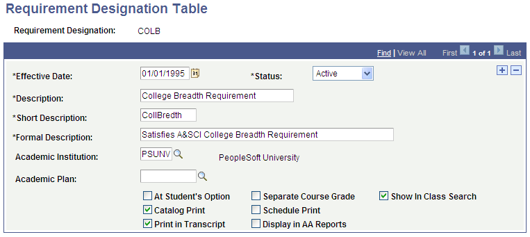

Access the Requirement Designation Table page (select Set Up SACR, then select Product Related, then select Student Records, then select Curriculum Management, then select Requirement Designation Table, then select Requirement Designation Table).
Image: Requirement Designation Table page
This example illustrates the fields and controls on the Requirement Designation Table page. You can find definitions for the fields and controls later on this page.
Field or Control
Definition
Status
Select a status for this requirement designation. Select Active when adding a new requirement designation. Select Inactive only if your institution no longer uses this requirement designation.
Description, Short Description, and Formal Description
Enter a description, short description, and formal description. The formal description appears on the course catalog report, schedule of classes report, and transcript if specified.
Academic Institution
Select an academic institution with which to associate the requirement designation. This affects the availability of this requirement designation on the course catalog and schedule of classes prompts.
Academic Plan
Select an academic plan if you want to link the requirement designation to a specific plan. At enrollment, a student must be active in the specified plan to enroll in any class with the related requirement designation. The Enrollment Request 1 page includes overrides that enable you to override this general rule if you have the appropriate security permissions. On the Enrollment page, the system does not validate this.
At Student's Option
Select to indicate that the student can select the requirement designation at enrollment. You can indicate a student's choice of requirement designation on the Enrollment Request Page, the Student Enrollment 4 page, or the Block Enrl Detail 2 page.
If you do not select this check box, students who enroll in classes that have this requirement designation are required to take the course and attempt the additional requirement designation credit.
See:
Catalog Print
Select to enable the display of the formal description of the requirement designation and the course in the course catalog report.
Note: The SSR_COURSE (Course Catalog) web service is one of a number of delivered Enrollment Web Services. The service operation SSR_GET_COURSES: Browse Course Catalog Summary obeys the Catalog Print setup that you select on the Requirement Designation Table page and on the Course Attributes page.
For detailed information about Enrollment Web Services, see Enrollment Web Services Developers Guide and Enrollment Web Services Users Guide in My Oracle Support (ID 1371391.1).
See
Schedule Print
Select to enable the display of the formal description of the requirement designation and the course in the schedule of classes report.
Print in Transcript
Select to print the requirement designation and requirement designation grade on the student's transcript.
Separate Course Grade
Select to indicate that the requirement designation involves work that someone must grade separate from the course. If this check box is cleared, students who earn credit for the course will, by default, earn a grade of Satisfied for the requirement designation. The professor does not need to assign two grades for every student (for example, a letter grade of B for the course, and a grade of Satisfied for the requirement designation).
Alternatively, should the professor want to evaluate a student on each of these two areas independently, select the check box. This setting is optimal in the event that a student receives a passing grade for the class, but fails to successfully complete the requirement designation. In this instance, the professor could assign a letter grade of B to the class, and assign a grade of Not Satisfied for the requirement designation. The class would not fulfill an advising requirement that requires both a class and a requirement designation for the class. It would fulfill only an advising requirement that requires the class alone.
See Using the Grade Roster Page to Enter Grades.
Display in AA Reports
Select to enable the system to display the requirement designation code and description in the advisement report.
Show in Class Search
If this check box is selected for a Requirement Designation and the Class Search Profile (for example, STDNT) includes a search criteria of Requirement Designation, then a student can search by the Requirement Designation in Self Service.
See Setting Up Class Search Profiles
See Searching for Classes Using Classic Self-Service Pages
