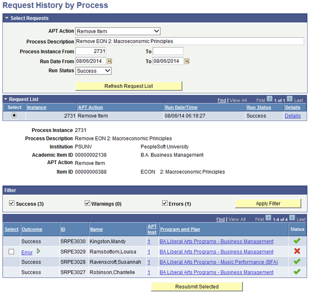

Request History by Process
SSR_APT_REQ_HIST
select Records and Enrollment, then select Program Enrollment, then select Request History by Process
View APT Action processes, outcomes and statuses.

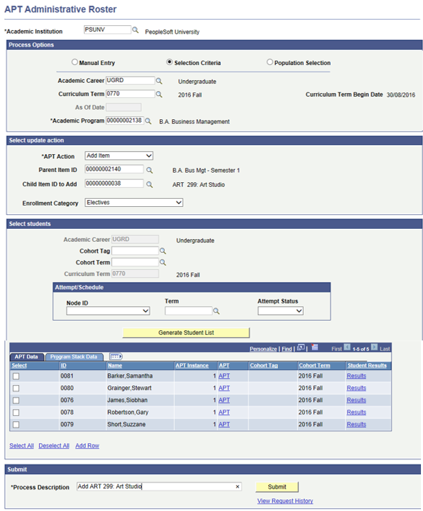

Access the APT Administrative Roster page (select Records and Enrollment, then select Program Enrollment, then select APT Administrative Roster).
Image: APT (Academic Progress Tracker) Administrative Roster page
This example illustrates the fields and controls on the APT (Academic Progress Tracker) Administrative Roster page. You can find definitions for the fields and controls later on this page.

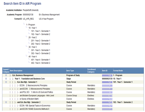

Parent Item ID
This prompt opens the Search Item ID in AIR Program page which provides a view of the AIR program. Select the parent item to which the child item will be added.
Note: The academic items available for selection are controlled by APT Action Security. See Setting Up APT Action Security

Image: Search Item ID in AIR Program page
Here is an example of the Search Item ID in AIR Program page:
Search Item ID in AIR (Academic Item Registry) Program page

Generate Student List
Click the Generate Student List button after you select criteria using Selection Criteria or Population Selection. When the student data is retrieved, you can access (view or update) the APT Instance or Program Stack data for a student directly from the roster page.
Image: APT (Academic Progress Tracker) Administrative Roster page: Generate Student List grid
This example illustrates the fields and controls on the APT (Academic Progress Tracker) Administrative Roster page: Generate Student List grid. You can find definitions for the fields and controls later on this page.
To process students for an APT Action, select individual students or Select All. Click Add Row to add a student to the list. The Student Results column provides access to the student’s XMLP results page. This is the same view as the student in Program Enrollment Self Service.

Image: APT (Academic Progress Tracker) Administrative Roster page: APT Action - Enter APT Status
This example illustrates the fields and controls on the APT (Academic Progress Tracker) Administrative Roster page: APT Action - Enter APT Status. You can find definitions for the fields and controls later on this page.
The APT Action Enter APT Status displays a grid when the Generate Student List is selected for the specific academic item. Using the grid, you can update the values for the APT statuses Satisfied, Attempt Outcome, and Attempt Status.
When you enter the APT status for groups of students for an academic item, the roster page identifies whether an APT status exists for a student. If an APT status exists, the row is display-only mode. To update any of the statuses, you must select the student ID so that the row is in edit mode. The same grid is displayed for APT Status Evaluation, and like the Calculate Results grid, a message column appears if there are any errors in the evaluation of a student’s APT statuses.
For APT Status Evaluation, see Using the Rules Engine for Program Enrollment Student Self-Service: System/Example Data document in My Oracle Support (ID 1400723.1).
Field or Control
Definition
Attempt Status
Records the overall attempt status of the academic item, for example, Finalized.
Attempt Outcome
Records the overall attempt outcome of the academic item, for example, Passed.
Satisfied
Records whether the academic item has been satisfied or not.
See Managing APT Items
See Setting Up Result Types
See Setting Up APT Reason Codes
Submit APT Actions (Add Item, Remove Item, Create Substitution, Enter Results, Enter APT Status)
You can run the APT action Submit as a background process. Alternatively, after submitting, you can view the process using the View Request History link and access the Request History by Process page.
See Monitoring APT Action Processes.
Use the Process Description field on the roster page to provide specific descriptions for each process that you submit, for example, Add Course Econ 2: Macroeconomic Principles. These descriptions are recorded in the process and can also be used when you search for specific processes in the Request History by Process component.

Use the Request History by Process page to monitor the details and outcomes of all APT Action processes submitted on the APT Administrative Roster page. You can monitor the request as it is submitted (the process instance ID is passed to the Request History by Process component), or view later after running the process in the background. You can also use the page to search for previous process instances submitted. If errors are returned during the submit process, you can fix them in the student’s APT or program stack directly from this page, and then resubmit the process.
Although the APT actions Calculate Results and APT Status Evaluation are not submitted to the process scheduler from the roster page, you can still access the results of the rules for these APT actions using the Request History component.
Access the Request History by Process page (select Records and Enrollment, then select Program Enrollment, then select Request History by Process).
Alternatively, access the page from the APT Administrative Roster page using the View Request History link.
Image: Request History by Process page
This example illustrates the fields and controls on the Request History by Process page. You can find definitions for the fields and controls later on this page.
Filter
Use the Filter grid to filter results based on different outcome statuses. For example, you can display the students that have an error status to resolve the data for those students.
Field or Control
Definition
Select
This check box appears only for those students who have an Error status. You can select student IDs for resubmission.
Outcome
The Outcome status is display only unless the outcome is an error, when a link provides details about the error message.
Resubmit Selected
You can resubmit the APT Action process for an individual or group of students. After the error has been resolved, select the student ID in the grid and click the Resubmit Selected button. You are returned to the APT Administrative Roster page where you can change the Process Description. Submit the process from the APT Administrative Roster page as previously, and then return to the Request by History process using the View Request History link to view the outcome of the process.
Note: For APT actions Calculate Results and APT Status Evaluation, resubmission is not available from the Request History component. The error messages are displayed on the roster page, which allows recalculation directly from the roster.
