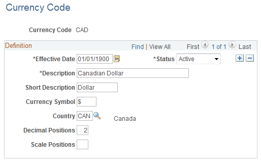

Image: Currency Code page
This example illustrates the fields and controls on the Currency Code page. You can find definitions for the fields and controls later on this page.

| Field or Control | Definition |
| Status | Indicate whether the currency code is active or inactive. If you inactivate a currency code that is in use, existing transactions are unaffected. However, the currency code is unavailable for future selections. Some PeopleSoft applications do not allow you to inactivate a currency code that is in use. |
| Currency Symbol | PeopleSoft applications deliver many currencies with a currency symbol such as $ for Australian dollar (AUD) or £ for British pound (GBP). You can enter new symbols for delivered currencies or for currencies that you might add. |
| Country | Select the code for the country from which the currency originates. Note: PeopleSoft applications deliver fully populated country, state, and province code tables and update these tables as national boundaries and designations change. |
| Decimal Positions | Enter the number of decimal positions that should appear in the notation for the currency. For example, there are two decimal positions for Australian dollars (500.00 AUD), but no decimal positions for Japanese yen (500 JPY). |
| Scale Positions | Enter the scale positions you want to round for this currency. This controls how many numbers appear to the left of the decimal when displayed. The data is actually stored with full precision in the database itself. For example, if you want all million-dollar amounts displayed as the number of millions without the zeros, enter 6 as your scale position. In this case, 24,000,000 is displayed as 24, but is stored in the database as 24,000,000. |
