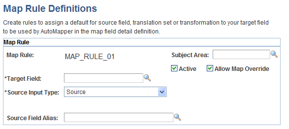

Use the Map Rule Definitions page (EOEW_RULE_DFN) to define map rules.
Navigation
Image: Map Rule Definitions page
This example illustrates the fields and controls on the Map Rule Definitions page. You can find definitions for the fields and controls later on this page.
Field or Control |
Definition |
| Active |
Select to make the rule active. Only active rules get used during an AutoMapper run. |
| Allow Map Override |
Select to allow the rule to be overridden on the Map Field Detail page. |
| Target Field |
Select the target field on which to base this rule. |
| Subject Area |
Select a subject area. For new rules, the default subject area is defined on the Subject Area page. |
| Source Input Type |
Source: Select to enable the Source Field Alias field, where you enter an alias for your source field if one is defined. If not, leave this field blank. AutoMapper always maps the alias into the selected target field. Transformation: Select to enable the Source field, where you enter a transformation object. AutoMapper always maps this transformation into the selected target field. Translation Set: Select to enable the Source Field Alias and Source fields, where you enter an alias and translation set. When AutoMapper sees the alias on the source, it always maps this translation set into the selected target field. |
