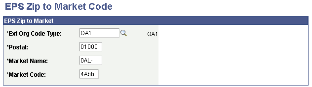

Access the EPS Zip to Market Code page ().
Image: EPS Zip to Market Code page
This example illustrates the fields and controls on the EPS Zip to Market Code page.
Market codes can be linked to many external organization code types. You can view market code descriptions on the EPS Market Code Table page.

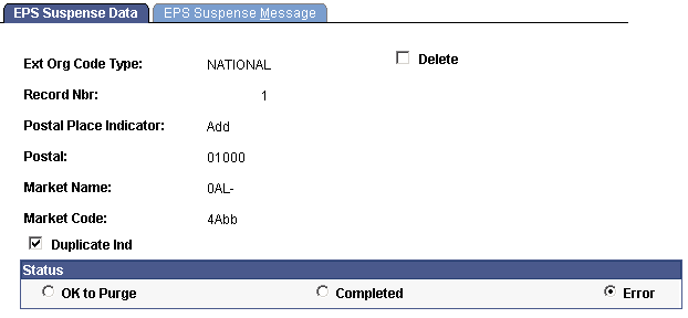

Access the EPS Suspense Data page ().
Image: EPS Suspense Data page
This example illustrates the fields and controls on the EPS Suspense Data page. You can find definitions for the fields and controls later on this page.
Field or Control |
Definition |
| Delete |
Select to mark this suspense record for deletion. The system deletes the record when you run the EPS Purge Suspense File process. |
| Duplicate Ind (duplicate indicator) |
The load process selects this check box when it finds a duplicate postal code, market name, and market code within the code type. |
Status
Field or Control |
Definition |
| OK to Purge |
Select to mark the record for purge. When you run the EPS Purge Suspense File process, this record is purged. |
| Completed |
The load process selects this option when the record has been successfully updated. |
| Error |
The load process selects this option when it encounters an error, such as a duplicate. The system indicates duplicates by selecting the Duplicate Ind check box. You can decide whether to delete a duplicate record by selecting the Delete check box, or to ignore the duplication by clearing the Duplicate Ind check box. |

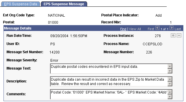

Access the EPS Suspense Message page ().
Image: EPS Suspense Message page
This example illustrates the fields and controls on the EPS Suspense Message page.

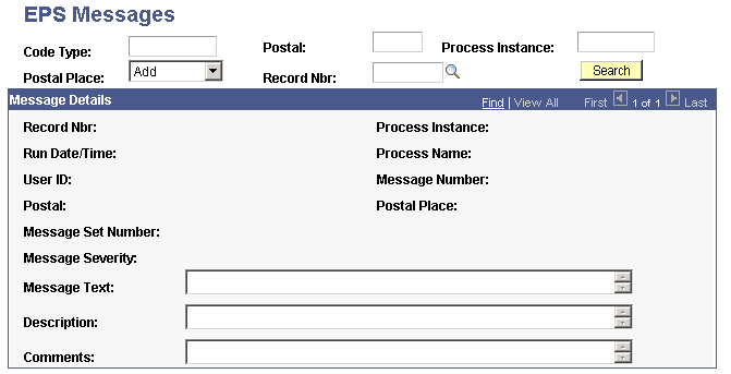

Access the EPS Messages page ().
Image: EPS Messages page
This example illustrates the fields and controls on the EPS Messages page. You can find definitions for the fields and controls later on this page.
Field or Control |
Definition |
| Code Type, Postal, Process Instance, Postal Place, and Record Nbr (record number) |
Use these fields to narrow the selection of messages that you want to display. |
| Search |
Click to display the messages based on your search. |
