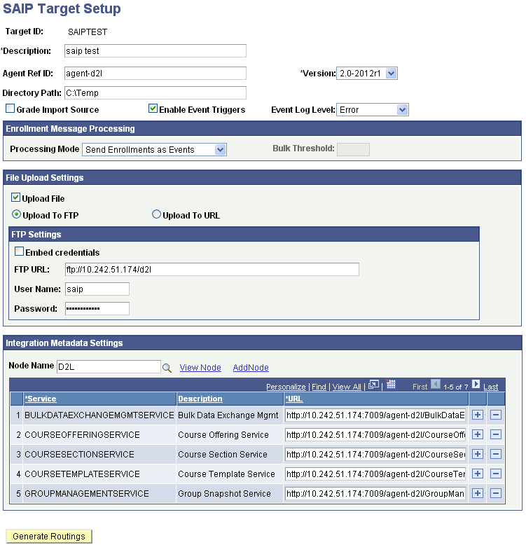

SAIP Target Setup |
SAE_TARGET_GENERAL |
Set up web service targets. |
Access the SAIP Target Setup page ().
Image: SAIP Target Setup page
This example illustrates the fields and controls on the SAIP Target Setup page. You can find definitions for the fields and controls later on this page.
SAIP autogenerates the routings in Integration Broker for each target.

Once the URLs have been entered, press Generate Routings to finish the target setup.
