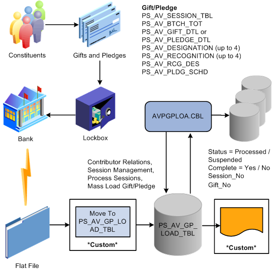

Because of the many variances between financial institutions and their databases, Campus Solutions does not deliver an API to populate the AV_GP_LOAD_TBL. The following diagram shows how the program might be incorporated into a lockbox process and which parts of that process are created and customized by your institution:
Image: How GP Load might fit into a lockbox process at your institution
This graphic illustrates an example of how GP Load might fit into a lockbox process at your institution:
