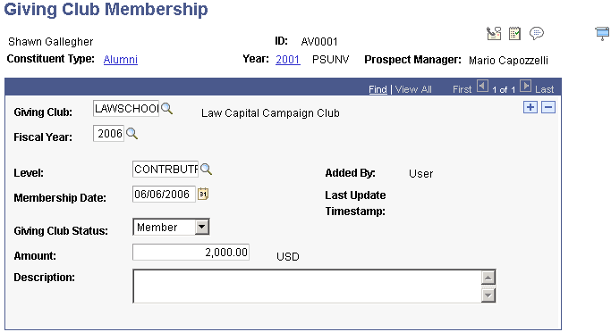

Access the Giving Club Membership page ().
Image: Giving Club Membership page
This example illustrates the fields and controls on the Giving Club Membership page. You can find definitions for the fields and controls later on this page.
To assign a donor to a giving club you must be the club's administrator. Other staff can view membership information on this page, but cannot update information.
Field or Control |
Definition |
| Giving Club |
Enter the giving club to which to assign the donor. Available options include valid giving clubs at your institution. |
| Fiscal Year |
Enter the fiscal year for the giving club membership. This field populates by default to the current fiscal year, but can be changed. |
| Level |
Enter the level within the giving club that the donor is qualified for. Level names are usually very specific for each institution and defined based on a donor's level of giving, but an example might include a giving club with levels of Member, Associate, Sponsor, and Benefactor. |
| Membership Date |
Enter the date on which the donor's membership in the giving club begins. |
| Giving Club Status |
Select the current state of the donor's status in the giving club. Values for this field are Member or Accruing. Select Member to automatically add the donor to a giving club. Accruing indicates that the donor is still working toward membership eligibility at the level you selected. |
| Amount |
Enter the amount of the donors giving that qualified them for the giving club. |

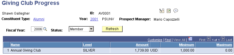

Access the Giving Club Progress page ().
Image: Giving Club Progress page
This example illustrates the fields and controls on the Giving Club Progress page. You can find definitions for the fields and controls later on this page.
Field or Control |
Definition |
| Fiscal Year |
Enter the fiscal year for which to view giving club information. This field populates by default to the current fiscal year, but can be changed. |
| Status |
Select the giving club status to view information about. Values are Member or Accruing. Member indicates that the donor is currently a member at the level you selected. Accruing indicates that the donor is still working toward membership eligibility at the level you selected. |
| Minimum and Maximum |
Displays the donation range that determine the low and high end of giving to make donors eligible for giving club membership at this level. |
