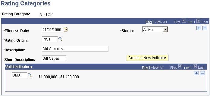

Access the Rating Categories page ().
Image: Rating Categories page
This example illustrates the fields and controls on the Rating Categories page. You can find definitions for the fields and controls later on this page.
Rating categories are descriptive classifications of a rating and are defined by your institution. They are used in prospect management to qualify prospects for giving. You assign ratings to a constituent on the Ratings page.
Examples of rating categories are Household Income, Gift Capacity, and Overall Readiness.

| Valid Indicators |
Valid indicators allow the appropriate values to appear for the category when entering a rating on the Ratings Indicator Page. Select the indicators that are applicable to the ratings category. For example, if the Ratings Category is Survey Results, only those ratings indicators pertinent to surveys would be valid indicators. |
| Create a New Indicator |
Click to access the Rating Indicators page, where you can add a new rating indicator code. |

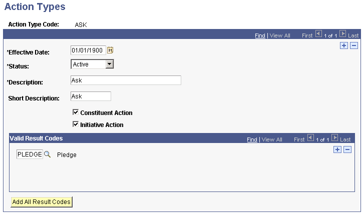

Access the Action Types page ().
Image: Action Types page
This example illustrates the fields and controls on the Action Types page. You can find definitions for the fields and controls later on this page.
An action type is the form of action that is taken with a particular donor prospect or for a particular initiative. For donor prospects, action types might include an ask, invitation, information gathering, or presentation proposal. For initiatives, action types might include a design session, vendor selection, or layout meeting.
When you create an action, you associate it with an action type. You can then track the information that is specific to that action type. For example, if the action type is Ask, you can enter an ask amount.

| Valid Result Codes |
Action types have certain expected outcomes. Result codes might be Accepted, Rejected, Submitted, Gift, or Pledge, for example. However, these are not all valid for every action type. Valid Result Codes are linked directly to Action Types. |
| Add All Result Codes |
Select the Add All Result Codes button to add all existing result codes to the action type. Once all are selected, the user may delete rows that are not pertinent. This is useful if more result codes apply than do not. |
Action Type Required Values
The following table describes the values that are required in the ACTN_TYPE_CD field that resides in the AV_ACTN_TYP_TBL table:
Code |
Value |
ASK |
Ask |
Field or Control |
Definition |
| Action Type Code |
Displays the code for the action type. Note: This value comes from the ACTN_TYPE_CD field in the AV_ACTN_TYP_TBL table. |
| Constituent Action |
Select if the action type applies to actions that are associated with prospects or constituents. |
| Initiative Action |
Select if the action type applies to actions that are generated through an initiative. |
The selections that you make on this page determine the values in the Action Type field prompt when you create an action.

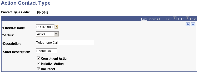

Access the Action Contact Type page ().
Image: Action Contact Type page
This example illustrates the fields and controls on the Action Contact Type page. You can find definitions for the fields and controls later on this page.
When you create an action or a volunteer assignment in Contributor Relations, you select a contact type. The contact type determines whether the person performs the action using a telephone call, a letter, an email, a personal visit, or some other method. For the purpose of managing prospects, a contact type could be a personal visit. For the purpose of managing initiatives, a contact type could be a meeting or phone call.
The selections that you make on this page determine the available values in the Contact Type field on the Volunteer Assignments 2 page, which you use when creating an action or a volunteer assignment.
Field or Control |
Definition |
Select if the contact type applies to prospect actions. |
| Initiative Action |
Select if the contact type applies to actions that are generated through an initiative. |
| Volunteer |
Select if the contact type applies to volunteer assignments. |

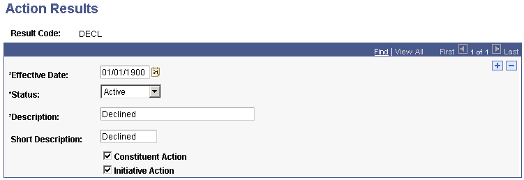

Access the Action Results page ().
Image: Action Results page
This example illustrates the fields and controls on the Action Results page. You can find definitions for the fields and controls later on this page.
The selections that you make on this page determine the values in the Result field on the Action Results page or used when completing a prospect action.
Field or Control |
Definition |
Select if the action result applies to prospect actions. Examples include accepted, proposal presented, gift, pledge, and declined. |
| Initiative Action |
Select if the action result applies to actions that are generated through an initiative. Examples of action results include confirmed, contract pending, and vendor selected. |

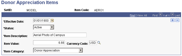

Access the Donor Appreciation Items page ().
Image: Donor Appreciation Items page
This example illustrates the fields and controls on the Donor Appreciation Items page. You can find definitions for the fields and controls later on this page.
Donor appreciation items are keyed by setID, so different business units can present different items to donors. A gift from a business unit might differ in look and cost, depending on the location that distributes it.
Examples of appreciation items are key chains, T-shirts, and pens.
Field or Control |
Definition |
| Item Category |
Select the item category to indicate whether the item is distributed for donor appreciation or as a membership benefit. The item category determines whether the item appears as an available item on the Donor Appreciation page or as a standard benefit on the Member Dues page. Note: If you use the same item for both purposes, the item should be entered twice with different codes so that it appears correctly as an available option. |
