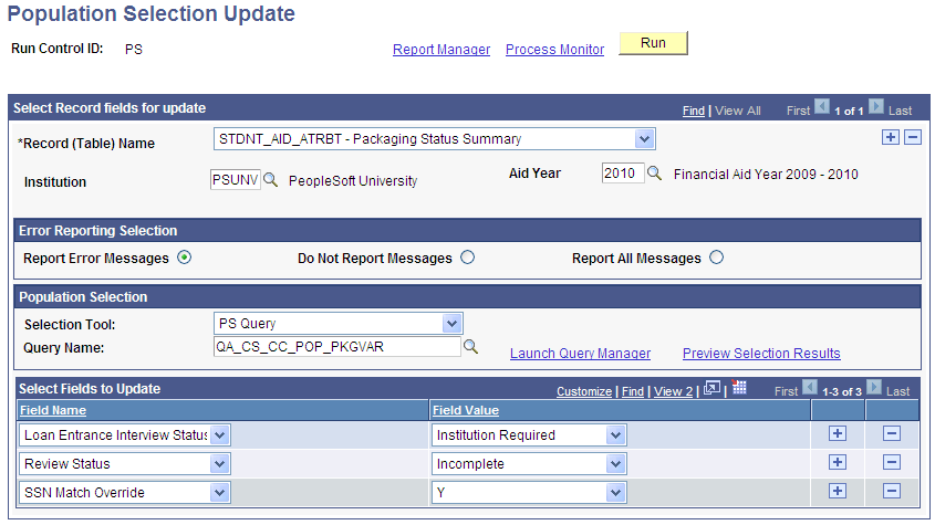

Access the Population Selection Update page ().
Image: Population Selection Update page
This example illustrates the fields and controls on the Population Selection Update page. You can find definitions for the fields and controls later on this page.
Select Record/Field for Update
Field or Control |
Definition |
| Record (Table) Name |
Select the name of the record to update. Only the records to which you have security access and that your institution or department has made available for updating are available values. Multiple tables can be updated on one run control. A table can be referenced only once per run control because the table is a key field for the process. When you enter the Record (Table) Name, the fields that are available for update become available for selection. |
| Institution and Aid Year |
Enter the Institution and Aid Year. When you enter the record name, the system displays the key fields for that record so that you can specify the exact rows to update in the table. For example, for Financial Aid records, the Institution and Aid Year fields appear. |
Error Reporting Selection
You can choose to have the process display error messages only or all of the messages that it encounters during the update, or you can choose not to display any of the messages. Displaying at least the error messages gives you an opportunity to decide whether to investigate and resolve the problems.
Fields and links in this group box behave as in the standard Population Selection group box throughout Campus Solutions.
See Understanding the Population Selection Group Box.
Field or Control |
Definition |
| Selection Tool |
Select the Selection Tool that your institution uses to select the population to update: PS Query, Equation Engine, or External File. |
| Query Name, Equation Name, or File Name |
Enter the name of the query, equation, or file that you use to select the population that you want to update. For PS Query, the list of available queries is determined by Record (Table) Name selected for update. |
Select Fields to Update
Field or Control |
Definition |
| Field Name and Field Value |
Select each field that you want to update and the value to use. When you run the Population Update process, the system finds the record and updates the field values with the values that you specify for the records that you have identified using the Population Selection utility. |
