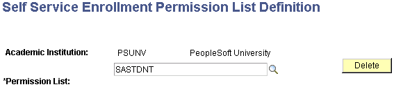

Access the Self Service Enrollment Permission List Definition page ().
Image: Self Service Enrollment Permission List Definition page
This example illustrates the fields and controls on the Self Service Enrollment Permission List Definition page. You can find definitions for the fields and controls later on this page.
Field or Control |
Definition |
| Permission List |
Enter the self-service permission list that you created. The academic institution is associated with the permission list. |
| Delete |
Click to delete the academic institution and permission list combination defined on the page. In the preceding example, the PSUNV/SASTDNT row would be deleted from the table. A warning message appears when you click the Delete button. |

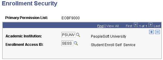

Access the Permission List - Enrollment Security page ().
Image: Permission List - Enrollment Security page
This example illustrates the fields and controls on the Permission List - Enrollment Security page. You can find definitions for the fields and controls later on this page.
Field or Control |
Definition |
| Academic Institution |
Enter an academic institution that a student can access for self-service enrollment using this permission list. |
| Enrollment Access ID |
Enter an enrollment access ID to allow students using this permission list to access the enrollment functions during the time periods specified in the enrollment access ID. |
