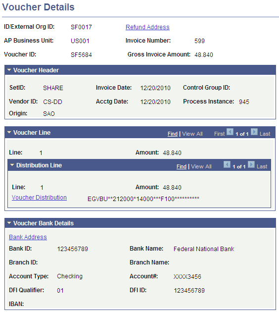

Access the Voucher Details page (Student Financials > Refunds > AP Direct Deposit > Review Vouchers > Voucher Details).
Image: Voucher Details page
This example illustrates the fields and controls on the Voucher Details page. You can find definitions for the fields and controls later on this page.
The data on this page relates only to the Create Refund Voucher process.
After you run the Create Refund Voucher process, use this page to review details of refunds interfaced to AP.
The values in the SetID, Control Group, Vendor ID, Origin, DFI Qualifier, and DFI ID field are based on the setup on the AP Business Unit Options page.
The Vendor ID, DFI Qualifier, and DFI ID values are required by AP to process a single payment voucher.

Vendor ID
If the refund is a direct deposit, this value is based on the Direct Deposit Vendor ID value on the AP Business Unit Options page. If the refund is a check, the value is based on the Check Vendor ID value.
DFI Qualifier
This value is based on the option that is selected in the DFI Qualifier group box on the AP Business Unit Options page: Transit Number or Swift ID.
DFI ID
This value is derived by the Create Refund Voucher process. If the DFI Qualifier is Transit Number, the DFI ID is similar to the routing number. If the DFI Qualifier is Swift ID, the DFI ID is similar to the BIC code.
Refund Address
Click this link to view Student Name, Email, and Refund address details.
Voucher Distribution
Click this link to view the GL Business Unit and Chartfields information.
Bank Address
Click this link to view the bank/branch address details (from the bank/branch set up in Common Objects).
See Setting Up Banks and Bank Branches.
