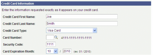

Image: Electronic Payment Test page (1 of 4)
This example illustrates the fields and controls on the Electronic Payment Test page (1 of 4). You can find definitions for the fields and controls later on this page.

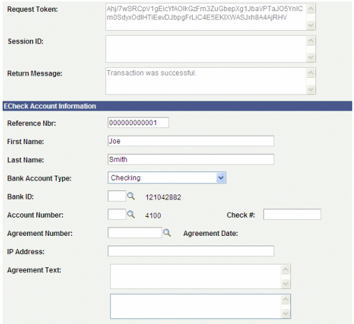

Image: Electronic Payment Test page (2 of 4)
This example illustrates the fields and controls on the Electronic Payment Test page (2 of 4). You can find definitions for the fields and controls later on this page.

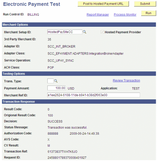

Image: Electronic Payment Test page (3 of 4)
This example illustrates the fields and controls on the Electronic Payment Test page (3 of 4). You can find definitions for the fields and controls later on this page.

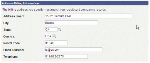

Image: Electronic Payment Test page (4 of 4)
This example illustrates the fields and controls on the Electronic Payment Test page (4 of 4). You can find definitions for the fields and controls later on this page.

Post to Hosted Payment URL
Click this button to cause a redirect to the third party URL where a sample payment can be made. The third party site should redirect you back to this page after the payment is made. You can then authorize the payment by using the Trans. Type field to select the Authorize Only (92) transaction.
Note: The Session ID field should be updated after you select either Authorize Only (92) or Credit Only (93) transaction.
This button is available only for payment merchants who are hosted payment providers.
Submit
Click this button to submit the transaction using the Electronic Payment API.
Run
Click this button to run the batch electronic payment test program. This program tests credit card and eCheck transactions (Authorize and Debit) to make sure that these transactions function correctly in a batch environment (this is more relevant when using the Business Interlink adapter).
When you initiate the batch run job, be sure to select only Transaction Type 1 – Authorize Only (CC) or Transaction Type 5 – Make a Payment (ACH).
