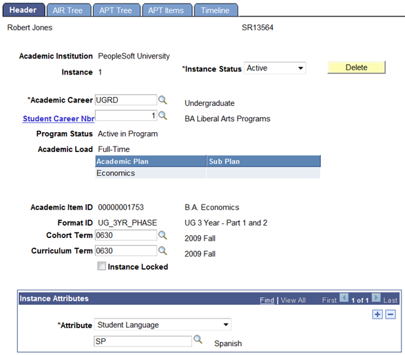

Image: Header page example: attributes
Attributes are assigned using the Instance Attributes scroll area:

| Attribute |
The name of the attribute. This value comes from the description entered for the attribute on the Common Attribute component. |
| Value |
This field changes depending on the type of attribute. This could be a numeric, date, time or text field. Alternatively, the field could prompt against a list of values if one has been defined for the attribute. |
