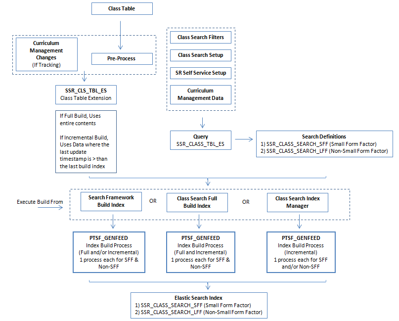

Image: Overview of Class Search and Elasticsearch Administrative Process
This diagram is an overview of the administrative processes required to build class search indexes

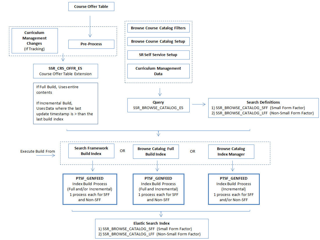

Image: Overview of Course Search and ElasticSearch Administrative Process
This diagram is an overview of the administrative processes required to build course search indexes

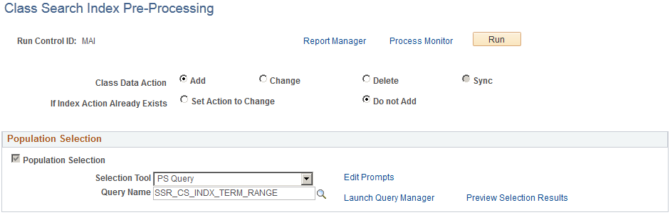

Access the Class Search Index Pre-Processing page ().
Image: Class Search Index Pre-Processing page
This example illustrates the fields and controls on the Class Search Index Pre-Processing page. You can find definitions for the fields and controls later on this page.
Use this page to determine which schedule of classes are available in class search. Initially, this process should be run to add classes for terms that you want to be available in class search. You can also use this page for ongoing maintenance.

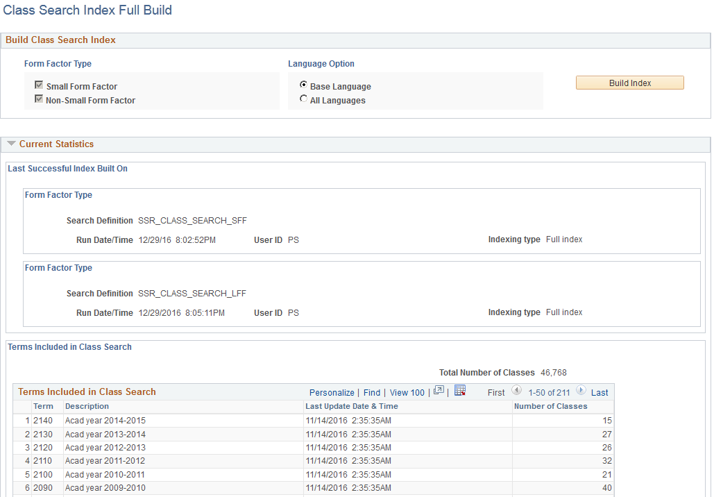

Access the Class Search Index Full Build page ().
Image: Class Search Index Full Build page
This example illustrates the fields and controls on the Class Search Index Full Build page. You can find definitions for the fields and controls later on this page.
The full build process should be run after the initial implementation of Elasticsearch, PeopleSoft Search Framework search definitions, and setting up class search for Fluid. The process runs for both small and non-small form factor devices. It indicates the terms and number of classes that have had indexes built.
Warning! Running the full index build process prevents self-service class search from displaying search results as all the indexes are rebuilt. Exercise extreme care when running this process. Make sure you run this process only during system downtime or when students do not have access to Class Search.
Oracle recommends that a select few users should have access to this process.
You must run a full build if you make any changes (like adding or removing facets) to PeopleSoft Search Framework. The Class Search Index Full Build page allows you to submit a full build for small and large form factor devices. Alternatively, you can also submit a full build using the Schedule Search Index ().
If you do not want to run a full build, add or remove delivered facets using the Search Category page. See Configuring PeopleSoft Search Framework for Search in Fluid.

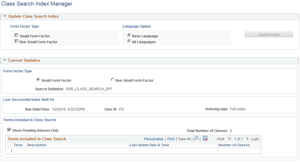

Access the Class Search Index Manager page ().
Image: Class Search Index Manager
This example illustrates the fields and controls on the Class Search Index Manager. You can find definitions for the fields and controls later on this page.
Use the Class Search Index Manager page to manually trigger an incremental build. The process indicates which class changes are to be made. This page displays pending classes that require an incremental build, and allows the submission of an incremental build process. The incremental build process does not prevent class search results from being displayed as not every index is rebuilt.

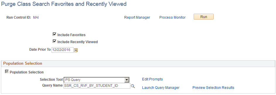

Access the Purge Class Search Favorites and Recently Viewed page (.
Image: Purge Class Search Favorites and Recently Viewed
This example illustrates the fields and controls on the Purge Class Search Favorites and Recently Viewed. You can find definitions for the fields and controls later on this page.
Use this page to remove either favorites or recently viewed classes—or both—from class search. Because favorites and recently viewed classes are term-specific, you normally run this process at the end of the term.
Field or Control |
Definition |
| Date Prior To |
Select to define the date when data should be removed. |
Campus Solutions provides the following queries:

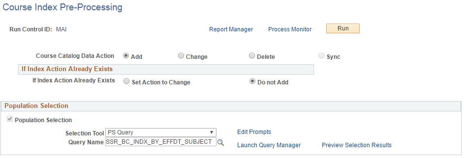

Access the Course Index Pre-Processing page ().
Image: Course Index Pre-Processing page
This example illustrates the fields and controls on the Course Index Pre-Processing page. You can find definitions for the fields and controls later on this page.
Use this page to determine which courses appear in the course catalog. Initially, you run this process to make courses available for search in the course catalog. You can also use this page for ongoing maintenance.

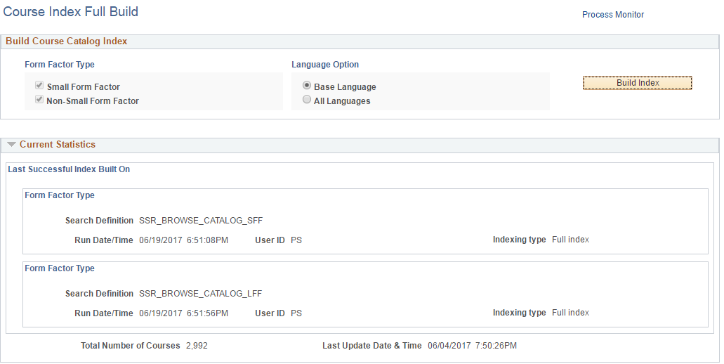

Access the Course Index Full Build page ().
Image: Course Index Full Build page
This example illustrates the fields and controls on the Course Index Full Build page. You can find definitions for the fields and controls later on this page.
You should run the full build process after the initial implementation of Elasticsearch, PeopleSoft Search Framework search definition, and configuring display settings for the course catalog in PeopleSoft Fluid User Interface. The process runs for both small and non-small form factor devices. It indicates the number of courses that have had indexes built.
Important! Running the full index build process prevents the course catalog from displaying search results as all the indexes are being rebuilt. Exercise extreme care when running this process. Make sure you run this process only during system downtime or when students do not have access to course search (Browse Course Catalog).
Oracle recommends that only a select few users have access to this process.
You must run a full build if you make any changes (such as adding or removing facets) to PeopleSoft Search Framework. The Course Index Full Build page allows you to submit a full build for small and non–small form factor devices.
If you do not want to run a full build, you can add or remove delivered facets using the Search Category page. See Configuring PeopleSoft Search Framework for Search in Fluid.

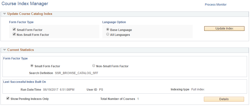

Access the Course Index Manager page ().
Image: Course Index Manager page
This example illustrates the fields and controls on the Course Index Manager page. You can find definitions for the fields and controls later on this page.
Use the Course Index Manager page to manually trigger an incremental build. The process indicates which course changes are to be made. This page displays pending courses that require an incremental build, and allows the submission of an incremental build process. The incremental build process does not prevent course search results from being displayed as not every index is rebuilt.

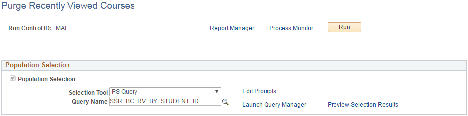

Access the Purge Recently Viewed Courses page (.
Image: Purge Recently Viewed Courses page
This example illustrates the fields and controls on the Purge Recently Viewed Courses page. You can find definitions for the fields and controls later on this page.
Use this page to remove recently viewed courses from browse course catalog.
