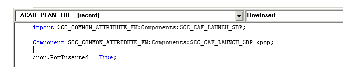

On the SCC_CAF_LAUNCH_SBP subpage, in the RowInsert event of the CAF-enabled record, set the RowInserted property to True. We recommend you add the following inline code in the Component Record PeopleCode:
import SCC_COMMON_ATTRIBUTE_FW:Components:SCC_CAF_LAUNCH_SBP;
Component SCC_COMMON_ATTRIBUTE_FW:Components:SCC_CAF_LAUNCH_SBP &pop;
&pop.RowInserted = True;
Image: SCC_CAF_LAUNCH_SBP- Inline code example
This example illustrates using inline code on the SCC_CAF_LAUNCH_SBP subpage.
SCC_CAF_LAUNCH_SBP- inline code example

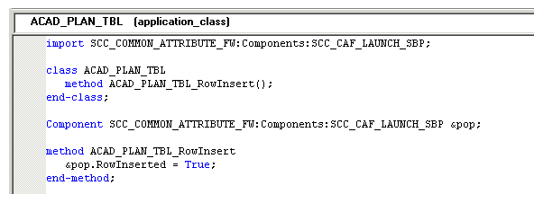

On the SCC_CAF_LAUNCH_SBP subpage, in the RowInsert event of the CAF-enabled record, set the RowInserted property to True. We recommend this method if other Component PeopleCode has been administered or is to be administered in a dedicated Application Class.
  1. Set the RowInserted property by adding a new method to either to an existing application class or to a new application class. In this example, the method is added to SSR_COMMON_UTILITIES:COMPONENTS.
    Class ACAD_PLAN_TBL
    Method ACAD_PLAN_TBL_RowInsert();
    End-class;
    method ACAD_PLAN_TBL_RowInsert
    end-method;
    Image: SCC_CAF_LAUNCH_SBP- Application class code example (1 of 2)
    This example illustrates using application class code on the SCC_CAF_LAUNCH_SBP subpage.
    SCC_CAF_LAUNCH_SBP- application class code example (1 of 2)

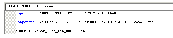

  2. Call the new method in the record’s RowInsert event.
    import SSR_COMMON_UTILITIES:Components:ACAD_PLAN_TBL;
    Component SSR_COMMON_UTILITIES:Components:ACAD_PLAN_TBL &acadPlan;
    &acadPlan.ACAD_PLAN_TBL_RowInsert();
    Image: SCC_CAF_LAUNCH_SBP- Application class code example (2 of 2)
    SCC_CAF_LAUNCH_SBP- application class code example (2 of 2)
