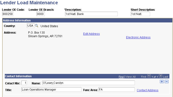

Access the Lender Load Maintenance page (Set Up SACR > Product Related > Financial Aid > Loans > CommonLine 4 > Maintain Lender Codes > Lender Load Maintenance).
Image: Lender Load Maintenance page
This example illustrates the fields and controls on the Lender Load Maintenance page. You can find definitions for the fields and controls later on this page.
Field or Control
Definition
Edit Address
Click to edit or update an address.
Electronic Address
Click to edit or update an electronic address.
Contact Address
Click to edit or update a contact address.

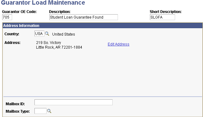

Access the Guarantor Load Maintenance page (Set Up SACR > Product Related > Financial Aid > Loans > CommonLine 4 > Maintain Guarantor Codes > Guarantor Load Maintenance).
Image: Guarantor Load Maintenance page
This example illustrates the fields and controls on the Guarantor Load Maintenance page. You can find definitions for the fields and controls later on this page.
Field or Control
Definition
Mailbox ID
Enter mailbox identification. The mailbox ID is the address where data files are sent when the files are transmitted using the internet or a private communication network.
Mailbox Type
Select an internet provider or communication network.

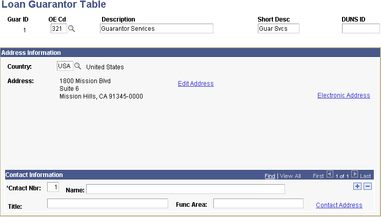

Access the Loan Guarantor Table page (Set Up SACR > Product Related > Financial Aid > Loans > CommonLine 4 > Define School Guarantors > Loan Guarantor Table).
Image: Loan Guarantor Table page
This example illustrates the fields and controls on the Loan Guarantor Table page. You can find definitions for the fields and controls later on this page.
To add new guarantors, you must first define them on the Guarantor Load Maintenance page.
Field or Control
Definition
Guar ID (guarantor identification)
Displays the number assigned by the system to identify the guarantor for loan processing. The system delivers the majority of guarantor codes.
OE Cd (office of education code)
Select an office of education code. When you select an office of education code, the system automatically populates the rest of the fields with information from the Guarantor Load Maintenance table.
Edit Address
Click to update or review address information.
Electronic Address
Click to update or review electronic address information.
Contact Address
Click to update or review contact address information.

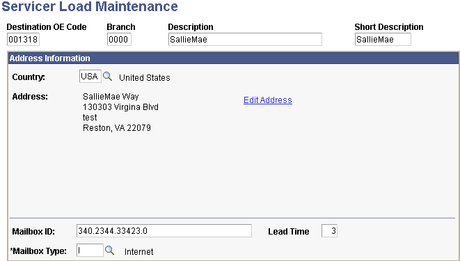

Access the Servicer Load Maintenance page (Set Up SACR > Product Related > Financial Aid > Loans > CommonLine 4 > Maintain Loan Servicer Codes > Servicer Loan Maintenance).
Image: Servicer Load Maintenance page
This example illustrates the fields and controls on the Servicer Load Maintenance page. You can find definitions for the fields and controls later on this page.
Field or Control
Definition
Destination OE Code (destination office of education code)
Lead Time
Enter the number of days prior to the first disbursement date that changes can still be made to the student's loan before the data is sent to the school. This is for information purposes only.
Edit Address

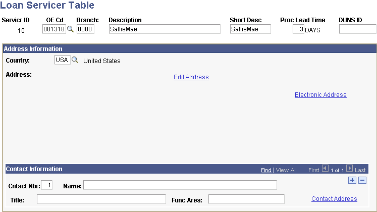

Access the Loan Servicer Table page (Set Up SACR > Product Related > Financial Aid > Loans > CommonLine 4 > Define School Servicers > Loan Servicer Table).
Image: Loan Servicer Table page
This example illustrates the fields and controls on the Loan Servicer Table page. You can find definitions for the fields and controls later on this page.
Field or Control
Definition
Servicer ID (servicer identification)
Displays the number used to identify the servicer associated with the requested loan.
Select an office of education code. When you select an office of education code, the system automatically populates the rest of the fields with information from the Servicer Load Maintenance table.
Proc Lead Time (process lead time)
Enter the number of days that a loan destination needs to freeze its data to prepare for a transfer to the school. For example, if the lead time is five days, changes can be made to the student's loan only five days prior to the first disbursement.
Edit Address
Electronic Address
Contact Address
