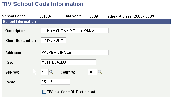

Access the TIV School Code Information page ().
Image: TIV School Code Information page
This example illustrates the fields and controls on the TIV School Code Information page. You can find definitions for the fields and controls later on this page.
You can add or correct information on this page if the U.S. Department of Education has made an error or omission in the description or address information for your institution.
Field or Control |
Definition |
| Title IV Inst Code DL Participant (Title IV institution code direct loan participant) |
Select if your institution participates in the federal Direct Lending Program. No processing is associated with this field. |

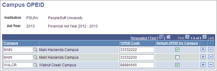

Access the OPEID Codes page ().
Image: Campus OPEID page
This example illustrates the fields and controls on the Campus OPEID page.
Use this page to set up campus OPEID codes for campuses and designate default codes.
COD requires schools to report a student's physical campus of attendance as the Enrollment School Code using the 8 digit OPEID codes assigned to your institution. You may enter as many unique combinations as is required to support your processing. However only one unique Campus and OPEID Code combination can be designated as the default for COD disbursement use. COD processing uses Campus OPEID setup and the Campus field on a student's Financial Aid Term record to determine what OPEID Code should be reported to COD as the Enrollment School Code. The Enrollment School Code is maintained at an individual disbursement level and can be overridden for an individual student on the student's COD Origination record. Once an actual disbursement has been reported to COD, the field is no longer be available for override.
The Enrollment School Code can also be updated on both the Loan and Pell origination disbursement records with the Population Update process.
See Reviewing Pell Disbursement Results.
See Viewing Loan Status Summary Information.
See Using the Population Selection Process.
Field or Control |
Definition |
| Campus |
Select a campus to assign an OPEID Code to. |
| OPEID Code |
Enter the OPEID code for the selected campus. |
| Default OPEID Code |
Check this box if you want the this Campus and OPEID Code combination to be the default value used for this campus in COD processing. |

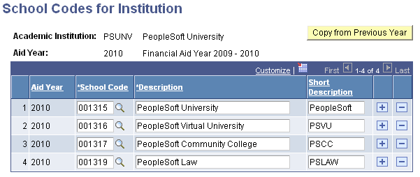

Access the School Codes for Institution page ().
Image: School Codes for Institution page
This example illustrates the fields and controls on the School Codes for Institution page. You can find definitions for the fields and controls later on this page.
Field or Control |
Definition |
| School Code |
Select the school code that you want to associate with the displayed aid year. If your institution has more than one school code, you can add rows and enter as many school codes as you need. |
| Copy from Previous Year |
Click to copy the school codes entered for the previous aid year to the current aid year. This process overrides any information that you have entered for the current aid year. |
