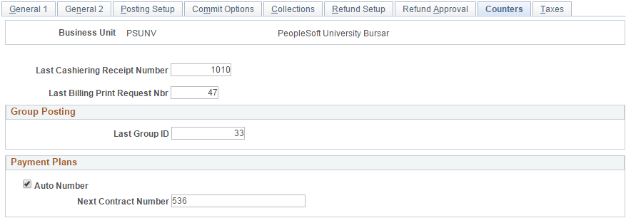

Counters
BUS_UNIT_TBL_SF8
Set Up SACR > Product Related > Student Financials > SF Business Unit > Counters
Define auto-numbering sequences.

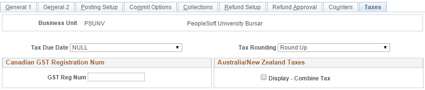

Taxes
BUS_UNIT_TBL_SF19
Set Up SACR > Product Related > Student Financials > SF Business Unit > Taxes
Define tax parameters for students from Canada, Australia, and New Zealand and tax calculation options.

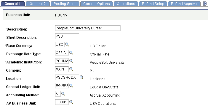

Access the General 1 page (Set Up SACR > Product Related > Student Financials > SF Business Unit > General 1).
Image: General 1 page
This example illustrates the fields and controls on the General 1 page. You can find definitions for the fields and controls later on this page.
General 1 page
Field or Control
Definition
Base Currency
Confirm or select the base currency that you want this business unit to use. The default value is the base currency selected for the institution in Set Up Common Objects > Install > Installation Table > Settings and Defaults. You can override the base currency for each business unit.
Exchange Rate Type
Select the exchange rate type that you use to convert other currency types to the base currency. The exchange rate type is necessary for the posting of charges.
Note: You define exchange rate types on the Currency Rate Type field (same navigation as above).
Academic Institution
Identify the academic institution that contains the SF business unit.
Campus
Enter the appropriate campus for the SF business unit.
Location
Enter the appropriate location for the SF business unit.
General Ledger Unit
If your institution uses PeopleSoft Financials, select the general ledger unit that receives information from the SF business unit. Otherwise, leave this field blank.
Accounting Method
Select your institution's accounting method: Accrual, Cash, or Modified Cash accounting.
AP Business Unit
Select the business unit with which your system interacts when processing refunds through the accounts payable department.

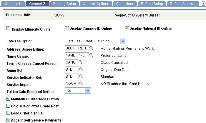

Access the General 2 page (Set Up SACR > Product Related > Student Financials > SF Business Unit > General 2).
Image: General 2 page
This example illustrates the fields and controls on the General 2 page. You can find definitions for the fields and controls later on this page.
General 2 page
Field or Control
Definition
Display Ethnicity Online
Select this option if you want the student's ethnicity to appear on the Academic Information page.
Display Campus ID Online
Select this option if you want the campus ID to appear on the Academic Information page. The campus ID identifies the campus, not the student.
Display National ID Online
Select this option if you want the student's national ID (for example, social security number) to appear on the Academic Information page.
Late Fee Option
Select one of two Late Fee - Billing methods: Late Fees - Bill Request Nbr or Late Fees - Past Due/Aging.
Late Fees run control pages use this option to verify that the correct process is used before processing.
You can use two distinct processes to calculate late fees. One method is based on the account aging or the due date. The other method is based on a billing request number using the amount billed as a basis.
Address Usage Billing
Select a default address usage type to use when you generate customer bills.
Name Usage
Select a default name usage type.
Term/Class Cancel Reason
Select a term/class cancellation code that you want to use as the default reason when you run the Term/Class Cancellation process.
Aging Set
Select the aging set that the system uses by default for the Assign Collector process.
Service Indicator Set
Select the service indicator set to use. This service indicator set must include all service indicators that you want to use for credit history processing.
Service Impact
Select the service impact to use to stop a service indicator from being placed by the credit history process. This is a default value that isx used when credit history is called from the self-service pages.
Tuition Calc Required Default (tuition calculation required default)
Select Yes if you want the Tuition Calc Required flag set automatically when a student is activated in a term. Use this option if you want tuition to be calculated on Anticipated Units.
Select No if you do not want the Tuition Calc Required flag set automatically when a student is activated in a term. Use this option if you want tuition fees calculated only after enrollment activity (Bill Units).
Maintain GL Interface History
Select this option if you want the system to maintain general ledger interface history. This selection is required for you to use the Back Out GL Interface functionality.
Calc Tuition after Grade Post (calculate tuition after grade post)
Select this option if you want the Tuition Calc Required flag to be set to Yes whenever student grades are posted or changed through the Grade Roster page.
Note: This check box does not affect the Tuition Calc Required flag being set to Yes when grades are posted or changed through the Enrollment pages.
Load Criteria Table
Select this option if you want the criteria tables (for example, Career, Program, Fee Triggers, and so on) to be loaded into working storage at the beginning of the Tuition Calculation process. If you are using a large number of waiver criteria, fee triggers, and criteria for tuition groups, selecting this option can improve Tuition Calculation process performance.
Note: If more than 1000 total criteria values exist, this option must not be selected. Working storage is currently limited to 1000 maximum values.
Accept Self-Service Payments
Per SF business unit, select this option to allow students to make payments through self service. When you select this option, it appears on the Institution Set > Business Units > Accept Self-Service Payments page.
See Setting Up Institution Sets.

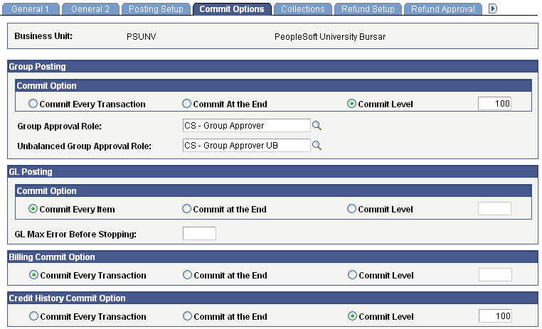

Access the Commit Options page (Set Up SACR > Product Related > Student Financials > SF Business Unit > Commit Options).
Image: Commit Options page
This example illustrates the fields and controls on the Commit Options page. You can find definitions for the fields and controls later on this page.
Commit Options page
Important! The selections that you make in this page have a specific effect on processing. Consult your IT staff and system administrators to determine the optimum selections for your processing needs.
See the product documentation for PeopleTools: Workflow Technology.
Group Posting
Set the levels at which group post transactions are committed to the database.
Field or Control
Definition
Commit Every Transaction
Select to commit each transaction when it is processed.
Commit At the End
Select to commit all the transactions that are contained in the batch being processed at the conclusion of that batch process.
Commit Level
Select to commit a specified number of transactions during background processing. For example, if you enter 100 in the Commit Level field, when you run a batch process the system processes 100 transactions and then commits them to the database until the batch is complete. At the end of a batch process, the system commits all remaining transactions even if the number of transactions is less than the number in the Commit Level field.
Group Approval Role
Select the role of the person or persons who can approve the group.
Unbalanced Group Approval Role
Select the role of the person or persons who can approve an out-of-balance group.
GL Posting
Set the levels at which general ledger transactions are committed to the database.
Commit Level
Select to commit a set number of transactions during background processing.
GL Max Error Before Stopping (general ledger maximum error before stopping)
Enter the maximum number of errors that you want the system to allow before stopping transaction processing.
Billing Commit Option
Set the levels at which billing transactions are committed to the database.
Field or Control
Definition
Commit at the End
Select to commit all the transactions that are contained in the batch being processed at the conclusion of that batch's process.
Commit Level
Select to commit a set number of transactions during background processing. Enter a commit level in the field to the right of this option.
Credit History Commit Option
Set the levels at which Credit History process transactions are committed to the database.

Access the Counters page (Set Up SACR > Product Related > Student Financials > SF Business Unit > Counters).
Image: Counters page
This example illustrates the fields and controls on the Counters page. You can find definitions for the fields and controls later on this page.
Counters page
With the exception of payment plans, the counter number fields on this page automatically display the last number used. You can specify a number with which you would like the sequence numbering to begin. For example, if you want cashiering receipt numbers to begin at 1,000, enter the number 999 in the Last Cashiering Receipt Number field. The system automatically assigns the number 1,000 to the first receipt produced and increments all receipts by 1 thereafter.
Field or Control
Definition
If you want to change the starting point of the numbering sequence for cashiering receipts, enter a number that is one less than the number that you want to begin with.
Last Billing Print Request Nbr (last billing print request number)
If you want to change the starting point of the numbering sequence for billing requests, enter a number that is one less than the number that you want to begin with.
Group Posting
Field or Control
Definition
Last Group ID
If you want to change the starting point of the numbering sequence for posting group ID numbers, enter a number that is one less than the number that you want to begin with.
Payment Plans
Field or Control
Definition
Auto Number
Select if you want the system to automatically generate sequential contract numbers for payment plan contracts.
Next Contract Number
If you want to change the starting point of the numbering sequence for payment plan contract numbers, enter the contract number that you want to begin with.
Unlike the previous counters, the Next Contract Number field displays the next number in the sequence.
Access the Taxes page (Set Up SACR > Product Related > Student Financials > SF Business Unit > Taxes).
Image: Taxes page
This example illustrates the fields and controls on the Taxes page. You can find definitions for the fields and controls later on this page.
Taxes page
Field or Control
Definition
Tax Due Date
Select a Tax Due Date option to control when taxes that are associated with charges are considered due. Options are:
Charge Due Date: Select to make taxes due on the same date as the corresponding charge.
Charge Effective Date: Select to make taxes due on the date that the corresponding charge becomes effective. This date may be different from the due date of the charge.
Null: Select if you do not want the system to automatically assign a due date. This setting leaves open the option of assigning a due date at a later point (for example, through the Billing process). This is the default setting.
Posting Date: Select to make tax charges due immediately on the date that the corresponding charge is posted.
Field or Control
Definition
Tax Rounding
This option controls how taxes are adjusted at the half-cent point. Different taxing authorities have different rules for how adjustments must be made. Determine the requirements for your institution before selecting an option. Rounding affects only tax amounts that are calculated to the exact half-cent point. Options are:
No Rounding: Select to truncate the calculated tax amount to the full-cent value. This option effectively eliminates any fraction of a cent. For example, 3.769 USD would be truncated to 3.76 USD. Fractions are never rounded up.
Round Down: Select if you want taxes that calculate to the half-cent point or less to be reduced to the nearest full-cent value. For example, 3.765 USD would be reduced to 3.76 USD.
Round Up: Select if you want taxes that calculate to the half-cent point or more to be increased to the nearest full-cent value. For example, 3.765 USD would be increased to 3.77 USD.
Student Financials rounds based on the third decimal place of a number.
Canadian GST Registration Num
Field or Control
Definition
GST Reg Num
Enter the GST (Goods and Services Tax) registration number that is assigned to this business unit. The system uses this value for any receipts and invoices that are specifically designed to include the GST registration number when GST is assessed.
Australia/New Zealand Taxes
Field or Control
Definition
Display − Combine Tax
Select to display transactions with tax included (summed). The default setting (check box cleared) displays taxes as a separate line item.
