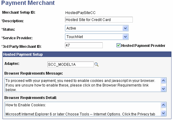

Field or Control
Definition
Service Provider
Select a service provider: Cybersource, TouchNet, or Unsupported.
This field is informational only.
3rd party Merchant ID
Enter the merchant name.
Hosted Payment Provider
Select this check box to identify the payment merchant as a hosted payment provider.
If you select this check box:
  • The Hosted Payment Setup group box becomes available.
  • The Security Code Supported check box in the Credit Card group box is not available, because that control is established (as well as collected) at the hosted payment (third party) site.
See Understanding ePayment Transactions.
This group box is available only if the Hosted Payment Provider check box is selected.
Field or Control
Definition
Adapter
Select the adapter to be used by the hosted payment merchant to process hosted payment transactions.
Browser Requirements Message and Browser Requirements Detail
Enter a browser-related message, or browser-related detail about browser requirements, that an application can display to a user before the user is transferred to the third party hosted site.
For schools that use hosted payment, the message that you enter here appears on the Make a Payment - Confirm Payment page if the Display Browser Message check box is selected on the Electronic Payments (Institution Set) setup page.
For schools that use hosted payment, the detail that you provide here appears when students click the Browser Requirements link on the Make a Payment - Confirm Payment page if the Display Browser Message check box is selected on the Electronic Payments (Institution Set) setup page.
See Defining Self-Service ePayments for Institution Sets.

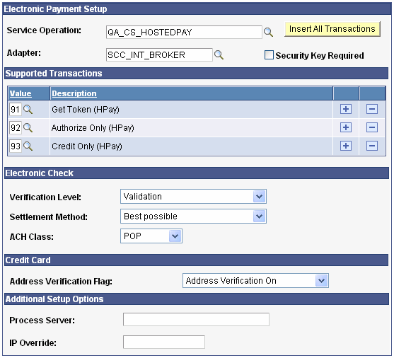

Electronic Payment Setup
Field or Control
Definition
Service Operation
Select the service operation to be used by the adapter when processing the electronic or hosted payment transaction request. This field is required only if you use the Integration Broker based adapter (SCC_INT_BROKER).
Adapter
Select the adapter to be used by this merchant to process electronic payment transactions using the electronic payment interface.
Insert All Transactions
Click this button to insert all transactions into the Supported Transactions group box.
Security Key Required
Use this check box to indicate that a special security token or password is needed to process transactions. If you select this check box, the Security Key Setup group box becomes available.
The following services are available for the ePayment API. Check with your third party provider for a list of supported services.
Field or Control
Definition
Value
Select a value for the supported transactions.
Credit Card transactions:
  • 1: Authorize Only
  • 2: Authorize and Bill
  • 3: Bill Only
  • 4: Credit Only
eCheck transactions:
  • 5: Make Payment
  • 6: Apply Credit
Hosted transactions:
  • 91: Get Token
  • 92: Authorize Only
  • 93: Credit Only
Electronic Check
Field or Control
Definition
Verification Level
Select the level of verification that the system uses for eCheck payments.
If a valid value is not entered on the transaction request, the value that you select here is used.
Validation: Select to test the format and bank routing number of each eCheck payment and to compare the transaction information to the check-processing partner's internal negative file.
Verification: Select to perform all validation steps and to compare each transaction's information with an external negative file to identify accounts that have a history of bad checks or that were closed for cause.
Note: Validation and verification are optional. Neither process checks the status or the existence of an account nor do they guarantee that funds are available.
Settlement Method
Select the default method that the system uses to deliver settlements to and from your students' banks.
Automated Clearing House: Select to deposit U.S. and Canadian transactions using the Automated Clearing House (ACH) or the Canadian Payment Association.
Facsimile draft: Select to deposit transactions as facsimile drafts. Use this method when the issuing bank is not an ACH member.
Best possible: Select to deposit transactions through the ACH system unless the student's bank is not an ACH participant, in which case, the system creates a facsimile draft and deposits it.
ACH Class
Select the default value for ACH Class data element used by eCheck transactions. If a valid value is not entered on the transaction request, the value that you select here is used.
The values are:
  • ARC (Accounts Receivable Entries): Checks received by a merchant through mail or drop box and presented as a HYPERLINK "http://www.nationalach.com" ACH entry.
  • POP (Point-of-Purchase): A check presented in-person to a merchant for purchase is presented as a HYPERLINK "http://www.nationalach.com" ACH entry instead of a physical check.
  • TEL (Telephone Initiated-Entry) Verbal authorization by telephone to issue a HYPERLINK "http://www.nationalach.com" ACH entry such as checks by phone.
  • WEB (Web Initiated-Entry): Electronic authorization through the Internet to create a HYPERLINK "http://www.nationalach.com" ACH.
Credit Card
Important! PeopleSoft Business Interlinks is a deprecated product. The Business Interlinks class currently exists for backward compatibility only. For new integrations, use Integration Broker instead.
Field or Control
Definition
Select this check box to indicate that the merchant supports the sending of Security Code values.
You must clear this check box for merchants using Business Interlink based integration technology.
Because the Security Code is captured at the third party site for hosted payment transactions, this check box is not available for hosted payment providers—that is, where the Hosted Payment Provider check box is selected.
Address Verification Flag
This field controls whether the system verifies the credit card billing address during credit card processing. The options are Address Verification Off and Address Verification On.
Note: If you select Address Verification On and the address given does not match, authorization is declined, but the credit card funds are set aside.
If a valid value is not entered on the transaction request, the value that you select here is used for credit card transactions.
This field also appears on the SF Merchants page.
Additional Setup Options
Field or Control
Definition
Process Server
This field holds the location of the Process Server used by the Business Interlink based credit card and eCheck transactions. This field is only relevant if you are using the Business Interlinks and the Business Interlink adapter (SCC_BUS_INTERLINK).
IP Override
This field is used by the credit card and eCheck business interlinks and is passed through the ip_address input property. This field is also used as a default IP address for transactions processed by the Integration Broker based adapter for electronic payment transactions that require this field.
See Electronic Payment Integration Developer's Reference Guide in My Oracle Support (ID 1982664.1).
