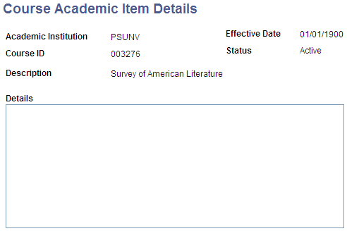

Access the Course Academic Item Details page (click the Details link on the Course Academic Item page).
Image: Course Academic Item Details page
This example illustrates the fields and controls on the Course Academic Item Details page . You can find definitions for the fields and controls later on this page.
Field or Control
Definition
Details
View details of all the academic items that have been created for the course. This is not a stored message and exists for the life of the component or until the Create Academic items button is clicked again.

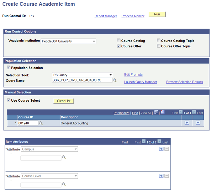

Access the Create Course Academic Item page (Curriculum Management > Academic Item Registry > Create Course Academic Item).
Image: Create Course Academic Item page
This example illustrates the fields and controls on the Create Course Academic Item page. You can find definitions for the fields and controls later on this page.
Run Control Options
Field or Control
Definition
Course Catalog
This check box is selected by default. The SSR_CRSE_AIR process creates an academic item for the course for the selected institution.
Course Catalog Topic
If this check box is selected, the process creates an academic item for each course topic that exists for the course ID.
Course Offer
If this check box is selected, the process creates an academic item for each course offering that exists for the course ID.
Course Offer Topic
If this check box is selected, the process creates an academic item for each course offering and topic combination that exists for the course ID.
Population Selection
The Population Selection group box is a standard group box that appears on run control pages when the Population Selection process is available or required for the transaction. Selection tools are available based on the selection tools that your institution selected in the setup of the Population Selection process for the application process and on your user security. Fields in the group box appear based on the selection tool that you select. The fields behave the same way from within the group box on all run control pages and application processes. If your institution uses a specific delivered selection tool to identify IDs for a specific transaction, you must use it.
Select the Population Selection check box to use the Population Selection process to select the courses for which you want to create academic items. When you select this check box, the Selection Tool and Query Name fields become available.
Field or Control
Definition
Selection Tool
Select External File or PS Query.
Query Name
The following queries are delivered:
  • SSR_POP_CRSEAIR_ACADGROUP: Select courses by institution and academic group.
  • SSR_POP_CRSEAIR_ACADORG: Select courses by institution and academic organization.
  • SSR_POP_CRSEAIR_BYDATE: Select courses by creation date using institution, operator id and date/time when the course was added.
  • SSR_POP_CRSEAIR_SUBJECT: Select courses by institution and course subject.
If you create queries, you must use the bind record SSR_CRSECAT_BND.
See Understanding Population Selection
See Using the Population Selection Process
Manual Selection
Field or Control
Definition
Use Course Select
If this check box is selected, you can manually select the courses for which you want to create academic items.
Clear List
Click this button to remove all Course ID rows and clear the Course ID field.
Item Attributes
Any attributes that have been defined in the Common Attribute setup as required for the Academic Item record context (SSR_AIR_HDR) and associated with the COURSE item type entity (‘AIR Course’) default into the Item Attributes scroll area. These attributes cannot be deleted and you must select a value in order to run the process.
See Using Item Attributes to Extend AIR Data Elements
See Defining a Common AttributeAssociating a Common Attribute to a Record
Running the Create Course Academic Items Process
Field or Control
Definition
Run
Click to run the SSR_CRSE_AIR process and create course academic items in AIR.
When an academic item is created:
  • The Item ID link appears on the Course Academic Item page.
  • The Course Academic Item link appears on the Offerings page in the Course Catalog component. Click the link to access the Course Academic Item page.
    See Creating Course Offerings
