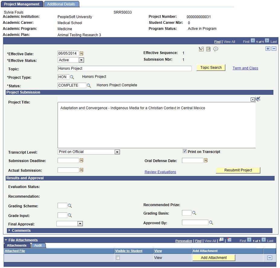

Access the Project Management page (Records and Enrollment > Academic Projects > Student Project Management > Project Management).
Image: Project Management page
This example illustrates the fields and controls on the Project Management page. You can find definitions for the fields and controls later on this page.
When you access this page in the Add mode to create a student academic project, you must specify the ID (EmplID), Academic Institution, and Academic Career of the matriculated student.

Project Number
The system generates a unique project number when you add a new student academic project.
Project Header Detail
Click to view the student's academic program and academic plan at the time when the academic project was created. This link will only appear if the student's program or plan values at the time of project creation do not match the student’s current program or plan.
Depending on the type of project and the institution's business rules, a change in the student's academic program or academic plan after the student has started the project may require a review and approval by the administrator. When this condition occurs, the system displays the Project Header Detail link and the link enables the administrator to review the change and make the appropriate adjustments, if necessary.
Additional Information
Click to access the Common Attributes subpage. This page uses the thesis common attributes record.
See Using Common Attribute Framework for Research Tracking
Send Notifications icon
For information about the Send Notification button,
See Using Online Notifications
Topic
Enter a topic in this field. Or click the Topic Search button to select a topic that you have set up in the Academic Project Topics – Topic Setup page.
Term and Class
Click to access the Term and Class page where you can associate the project with a term, session and class number.
Project Type
Select one of the values defined on the Academic Project Types page. You must select a project type to be able to enter a Status value.
Status
The status codes available here are determined by the group code defined for the project type. The status values of the group code are defined on the Process Status Codes page with the Project system usage value.
SeeSetting Up Research Status Codes
Project Submission
Field or Control
Definition
Project Title
Enter the project title in this field.
Transcript Level
Select the Transcript Level at which you want the Project Title information to be published.
Print on Transcript
Select this check box if you want to print Project Title information on the transcript.
Note: It is possible to print multiple Project Titles from a single project record. The transcript process selects the most recent row for each unique submission number where the Transcript Level is set and the Print on Transcript option is selected.
Submission Deadline
Date when the student should submit the project for evaluation.
Actual Submission
Track the actual submission of the project for evaluation.
Oral Defense Date
Enter the date of the oral defense, if required.
Review Evaluations
Click to access the Manage Evaluation component. If no matching evaluation record exists, the system prompts you to select an Evaluation Category and Evaluation Code to create the evaluation records.
See Managing Evaluations
Resubmit Project
Click if you want a new evaluation to be administered. This may be necessary if the first evaluation results in a non-passing score. Resubmitting the project will preserve the information and evaluation of the first project. A new evaluation will be generated for the resubmitted project. These is no limit to the number of times a project can be re-evaluated.
When you click this button, the system adds a new row to the page with the Submission Number incremented and the page fields reset to blank.
Results and Approval
Field or Control
Definition
Evaluation Status, Recommendation, Recommended Prize
Displays the values from the Manage Evaluation component.
Grading Scheme, Grading Basis, Grade Input
The system prompts you from the Grading Scheme Table page for these fields. The Grade Input represents the final grade assigned to the project.
See Defining Grading Schemes
Final Approval
Select Approved or Rejected to indicate whether the Head of Department (or perhaps the Dean or Chair of Examiners) has approved or rejected the project.
Approved
EmplID of the person who has given the final approval.

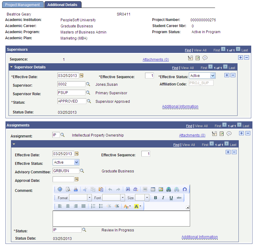

Access the Additional Details page (Records and Enrollment > Academic Projects > Student Project Management > Additional Details).
Image: Additional Details page
This example illustrates the fields and controls on the Additional Details page. You can find definitions for the fields and controls later on this page.
The Supervisors scroll area is used to assign the project supervisor(s). The prompt values for the Supervisor field are limited to records created in the Academic Projects – Administrator Profile Management page with the project supervisor role and are eligible to be assigned to the project.
See Assigning Candidate Supervisors
See Defining and Managing Administrator Profiles
The Assignments scroll area is used to track any school defined assignments for the project. This is similar to the Candidate Management - Other Assignments page.
See Tracking Additional Candidate Assignments
