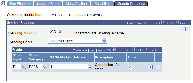

Module Outcome
SSR_HE_MODULE
Records and Enrollment > HESA Reporting > Codes and Mappings > Code Mappings > Module Outcome
Map Campus Solutions grading scheme, grading basis, grade input, and grade category codes to the HESA module outcome codes.

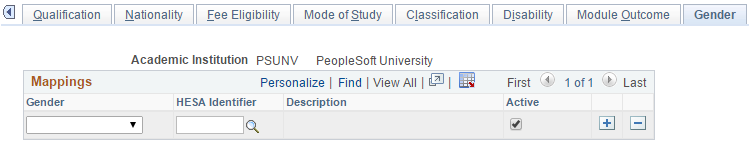

Gender
SCC_HE_GENDER
Records and Enrollment > HESA Reporting > Codes and Mappings > Code Mappings > Gender
Optionally, map Campus Solutions gender values to HESA gender identifiers.

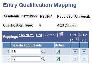

Entry Qualification Mapping
SSR_HE_QOE_MAP
Records and Enrollment > HESA Reporting > Codes and Mappings > Entry Qualification Mapping
Map a qualification type to a list of valid grades for that qualification. If grades are not mapped to a particular qualification type, then all the grades are available for a qualification type on the Entry Profile page. If you do this mapping, the Entry Profile page displays only the mapped grades for a type.

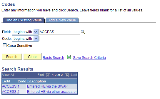

Access the Codes search page (Records and Enrollment > HESA Reporting > Codes and Mappings > Codes).
Image: Codes search page
This example illustrates the fields and controls on the Codes search page. You can find definitions for the fields and controls later on this page.
Codes search page
Use the Codes search page to search for all the codes of a specific field. If required, click the Add a New Value link to manually add a code for a field.

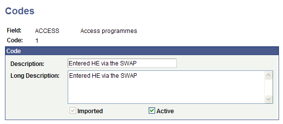

Click the Add a New Value link or click a link in the Search Results group box to access the Codes page.
Image: Codes page
This example illustrates the fields and controls on the Codes page. You can find definitions for the fields and controls later on this page.
Codes page
The text in the Description field can accept a maximum of 30 characters. Note that when you select a code on a data capture page, the page displays the text from the Description field. If the Import HESA Codes Application Engine (SSR_HE_IMPCD) process has cut a description text that extends beyond 30 characters, you can modify the description text so that a meaningful description appears on the data capture pages.

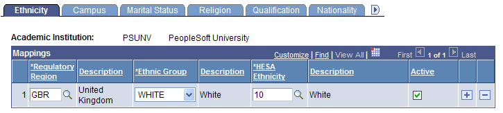

Access the Ethnicity page (Records and Enrollment > HESA Reporting > Codes and Mappings > Code Mappings > Ethnicity).
Image: Ethnicity page
This example illustrates the fields and controls on the Ethnicity page. You can find definitions for the fields and controls later on this page.
Ethnicity page
Map Campus Solutions regulatory region and ethnic group codes to the HESA ethnicity codes. The system uses this mapping to derive the Student.ETHNIC field values (for both Student and ITT returns).

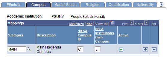

Access the Campus page (Records and Enrollment > HESA Reporting > Codes and Mappings > Code Mappings > Campus).
Image: Campus page
This example illustrates the fields and controls on the Campus page. You can find definitions for the fields and controls later on this page.
Campus page
Map the Campus Solutions campus codes to the HESA Campus ID and HESA Institutions Own Campus codes. The system uses this mapping to derive the Instance.CAMPID, Instance.INSTCAMP, and Provision.INSTCAMP field values.

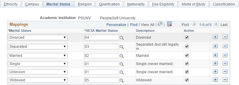

Access the Marital Status page (Records and Enrollment > HESA Reporting > Codes and Mappings > Code Mappings > Marital Status).
Image: Marital Status page
This example illustrates the fields and controls on the Marital Status page. You can find definitions for the fields and controls later on this page.
Marital Status page
Map the Campus Solutions marital status codes to the HESA marital status codes. The system uses this mapping to derive the EntryProfile.MARSTAT field value.

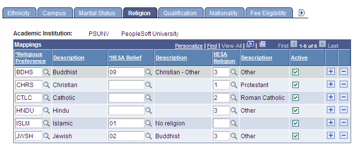

Access the Religion page (Records and Enrollment > HESA Reporting > Codes and Mappings > Code Mappings > Religion).
Image: Religion page
This example illustrates the fields and controls on the Religion page . You can find definitions for the fields and controls later on this page.
Religion page
Map the Campus Solutions religious preference codes to the HESA belief and religion codes. The system uses this mapping to derive the Student.RELBLF and EntryProfile.RELIGION field values.

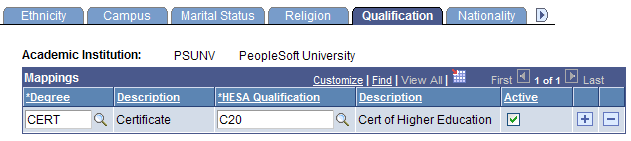

Access the Qualification page (Records and Enrollment > HESA Reporting > Codes and Mappings > Code Mappings > Qualification).
Image: Qualification page
This example illustrates the fields and controls on the Qualification page. You can find definitions for the fields and controls later on this page.
Qualification page
Map the Campus Solutions degree codes to the HESA qualification codes. The system uses this mapping to derive the Qualifications Awarded.QUAL field value.

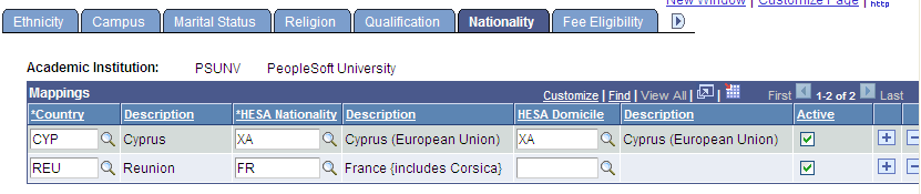

Access the Nationality page (Records and Enrollment > HESA Reporting > Codes and Mappings > Code Mappings > Nationality).
Image: Nationality page
This example illustrates the fields and controls on the Nationality page . You can find definitions for the fields and controls later on this page.
Nationality page
Map the Campus Solutions country codes to the HESA nationality codes. The system uses this mapping to derive the Student return's Student.NATION and EntryProfile.DOMICILE field values and ITT return's Student.DEGCTRY field value.
You map only certain Campus Solutions country codes to the HESA codes for Nationality. In most cases, the system can use the two-character Campus Solutions country code (COUNTRY_2CHAR) from the Country table (PS_COUNTRY_TBL).
Field or Control
Definition
HESA Nationality
Enter a value only if the two-character Campus Solutions country code is not a valid value for Student.NATION and Student.DEGCTRY. For example, the French territory of Reunion Island has its own country code RE but the academic institution must report the value as France FR in Student.NATION and Student.DEGCTRY.
If you do not select a value, the system uses the default two-character country code.
HESA Domicile
Enter a value only if the two-character Campus Solutions country code is not a valid value for EntryProfile.DOMICILE. If you do not select a value, the system uses the default two-character country code.
In the above exhibit example, the institution has mapped both Nationality and Domicile to XA for Cyprus. Therefore, if a student's record in Campus Solutions has a country code of CYP, the system uses the XA value for Student.NATION and Student.DEGCTRY, and uses the same value XA for EntryProfile.DOMICILE. Also, in the second row of the exhibit example, the setup indicates that if the student's record in Campus Solutions has a country code of REU (Reunion Island), then the system uses the value of FR for Student.NATION and Student.DEGCTRY. In such a case, because the HESA Domicile field has been left blank, the system uses the default two-character country code of RE for reporting EntryProfile.DOMICILE of the student.
See Nationality (NATION)
SeeDomicile (DOMICILE)

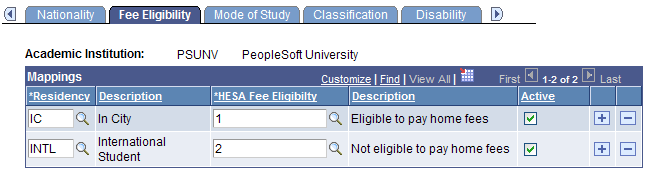

Access the Fee Eligibility page (Records and Enrollment > HESA Reporting > Codes and Mappings > Code Mappings > Fee Eligibility).
Image: Fee Eligibility page
This example illustrates the fields and controls on the Fee Eligibility page. You can find definitions for the fields and controls later on this page.
Map Campus Solutions residency codes to the HESA fee eligibility codes. The system uses this mapping to derive the Instance.FEEELIG field value.

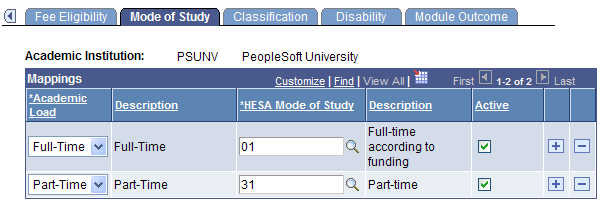

Access the Mode of Study page (Records and Enrollment > HESA Reporting > Codes and Mappings > Code Mappings > Mode of Study).
Image: Mode of Study page
This example illustrates the fields and controls on the Mode of Study page. You can find definitions for the fields and controls later on this page.
Mode of Study page
Map the Campus Solutions academic load codes to the HESA mode of study codes. The system uses this mapping to derive the Student return's Instance.MODE and ITT return's Student.MODE field values.

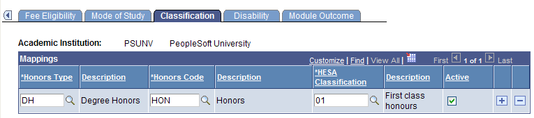

Access the Classification page (Records and Enrollment > HESA Reporting > Codes and Mappings > Code Mappings > Classification).
Image: Classification page
This example illustrates the fields and controls on the Classification page. You can find definitions for the fields and controls later on this page.
Classification page
Map the Campus Solutions honors code and type codes to the HESA classification codes. The system uses this mapping to derive the Qualifications Awarded.CLASS field value.

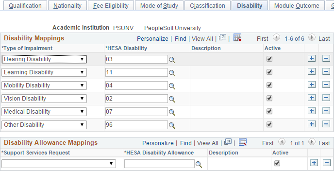

Access the Disability page (Records and Enrollment > HESA Reporting > Codes and Mappings > Code Mappings > Disability).
Image: Disability page
This example illustrates the fields and controls on the Disability page. You can find definitions for the fields and controls later on this page.
Disability page
Disability Mappings
Use this region to map the Campus Solutions type of Impairment codes to the HESA disability codes. The system uses this mapping to derive the Student.DISABLE field value (for both Student and ITT returns).
Disability Allowance Mappings
Use this region to map the Campus Solutions support services request codes to the HESA disability allowance codes. The system uses this mapping to derive the DISALL field value (for both Student and ITT returns).
Access the Module Outcome page (Records and Enrollment > HESA Reporting > Codes and Mappings > Code Mappings > Module Outcome).
Image: Module Outcome page
This example illustrates the fields and controls on the Module Outcome page. You can find definitions for the fields and controls later on this page.
Module Outcome page
Map the Campus Solutions grade input and grade category codes to the HESA module outcome codes. The system uses this mapping to derive the Student On Module.MODOUT field value.
Access the Gender page (Records and Enrollment > HESA Reporting > Codes and Mappings > Code Mappings > Gender).
Image: Gender page
This example illustrates the fields and controls on the Gender page . You can find definitions for the fields and controls later on this page.
Gender page
The system uses this mapping to derive the Student.SEXID field values for the Student and ITT returns.
Access the Entry Qualification Mapping page (Records and Enrollment > HESA Reporting > Codes and Mappings > Entry Qualification Mapping).
Image: Entry Qualification Mapping page
This example illustrates the fields and controls on the Entry Qualification Mapping page. You can find definitions for the fields and controls later on this page.
An institution can only return specific Grades (QUALGRADE) for a Qualification Type to HESA. If an invalid Grade is returned, then validation errors will occur at HESA. Use the Entry Qualification Mapping page to define which Grade values are appropriate for a particular Qualification Type. The system then uses this mapping to ensure that only valid Grade values are entered for the selected Qualification Type on the Entry Profile page. The Import Applicant Data process also uses this mapping when importing ivStarJ records to report invalid grade values.
